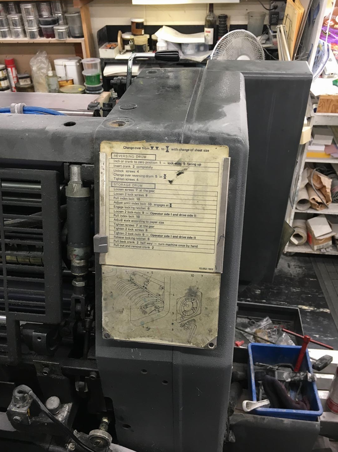

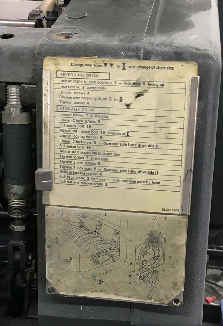

On our presses there is a step by step guide on the press itself see photos . .. (note these are for a GTO 52 perfector does not apply to anything other than location on the press . . . good luck
the instructions should also be in the press operation book

Repeat changeovers are not detrimental to the perfecting mechanisms! On the contrary, not changing over on a regular basis is far worse! Running in straight print only...or in perfecting only, is creating a wear factor on one portion of the rack and pinion gearing.
Don't know about wear on the rack and pinion but I know not adjusting items makes them more likely to freeze up, a long time ago I had a Hamada 770 and had the stripping down so well I didn't have to move the ring gear to adjust the vertical positioning . . . needed to one day and it had frozen . . . had to pull the whole cylinder to fix that one . . .
