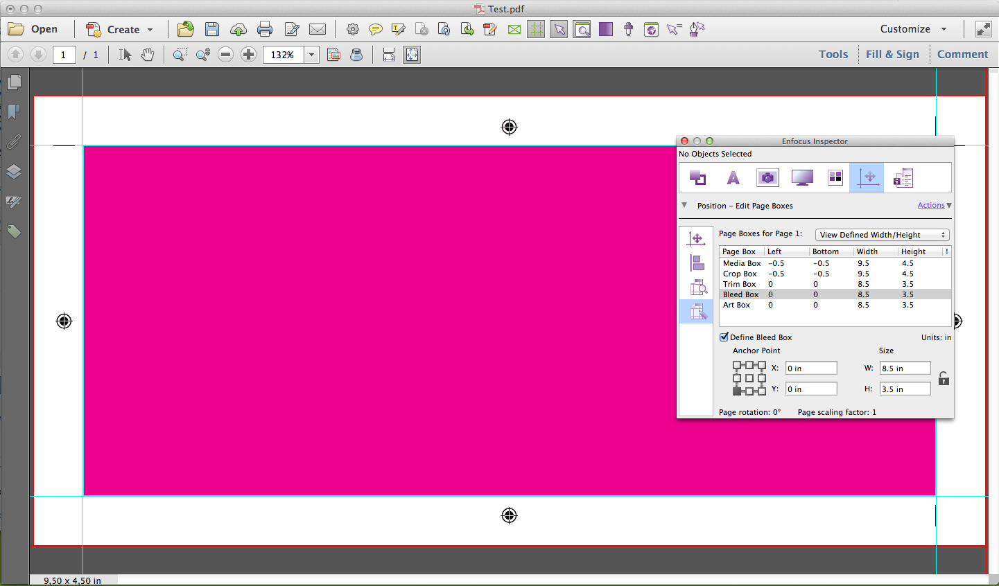

ABC - here is a test file.
I want to crop this down to red only. Then, increase the size to 9.5 wide x 4.5 tall. Then, in the white area, put in crop marks.
The Pitstop action I posted back on Pg. 1 of this thread still does this.

Reason is you will have to expand the crop box to show the crop marks etc for the required end result
Done!
Done!
Joe supplied the solution for this back in Comment 8 of the thread, just download the zip file and use the Action List he supplied.
Works exactly as needed, note crop box is the same size as media box.
