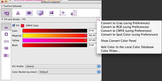

Select the color you want to add from within Inspector and then add it to the local database as shown in the attached image. You will have the option of naming it anything you please.

In the screen shot above select "Convert to Gray" while you have the item selected.

If it's type or a vector object just type the values in the CMYK boxes as shown in the screen shot above.

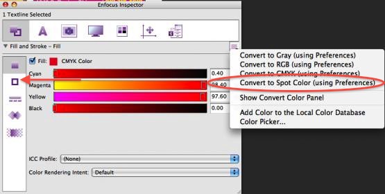

IF the color is defined as a spot then it should show up in output preview. There are a number of settings in output preview but by default all the separations should be visible. Try a save-as of the PDF. You can send it to me too.
Thanks. Now whats the secret to getting in the spot area?
Select the stroke on the left side of Inspector and then select "Convert to Spot Color (using Preferences)" from the flyout menu. Then select the Pantone book you want to use, pick your color and save. I had to save it and close it and re-open it for the spot color to show in the list of separations in Output Preview as Matt had already mentioned.
I'm sorry, I just realized what you did. I can do that, and maybe thats what we need to do now.
What we use to be able to do is name a color, and make it a spot color and have it show up in the output preview. Any way to do that now? we want to label them dieline.
