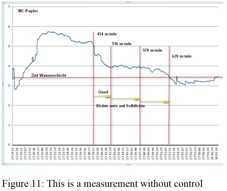

Mr. Cclyde, Kodak recommends to lower pre-dump as low as possible. Do your operators follow this recommendation?
And maybe your press operators should consider this:
The system was first used just to measure how the printer does set up the water manually. The example in figure 11 shows that the printer did use too much water at the start of the production. Printers do this very often, because they fear that by speeding up the press there could occur scumming, which leads to bad printing quality. The high water content makes the solid density degreasing. Since it is difficult for the printer to know how to correct for this problem, very often more ink is fed into the system, what leads to emulsification. The right measure would have been to reduce the water in-feed.
and one more thing – as far as i remember you're using hosman-steinberg/huber inks. If so – that's where your problem - overemulsification - arises
