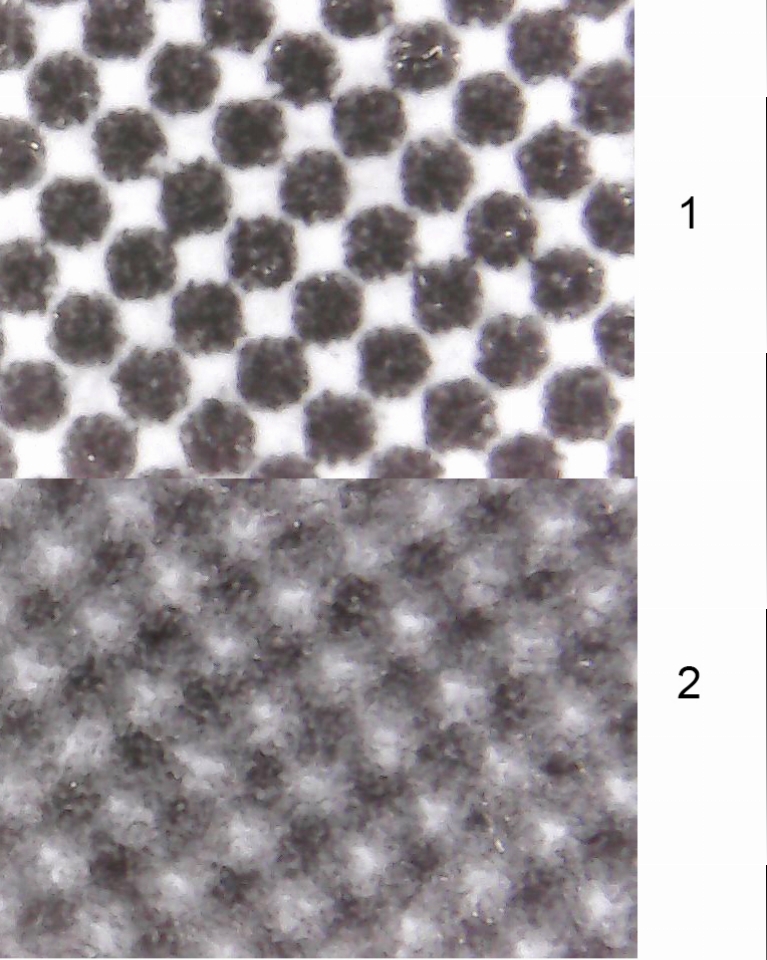

#1 and #2 are 45% bar on jobs run on same
press, K unit within a few days of each other.
Same stock, same side of stock, same bar,
same CTP, same plate brand.
We are having a disagreement on the cause
of this and I've been asked to get the opinions
of professionals without my opinion so as to not
lead or sway the answers.
Any input would be greatly appreciated.

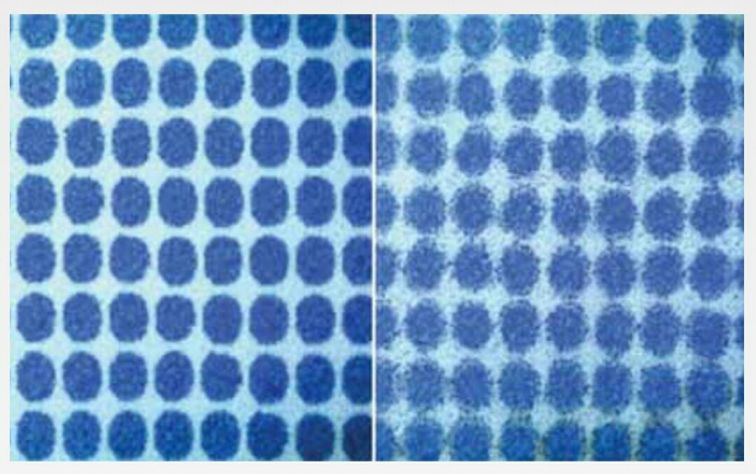

can we assume:
plate images are identical?
FS conductivity the same?
press settings the same?
ink the same?
nothing unusual done at press between printings?
Obviously, the aforementioned (and so much more) can impact printed results tremendously, so...can you share more info?
Lot of variables to consider there. DEFINATELY look at both plates under the scope to see if there is a noticeable difference. That will at least eliminate that. It could even be that the plate chemistry has gone off and needs a refresh. We used to gum the plates and rehang the same set for potential repeat order projects.
If the dots on the plates look the same run to run, try a couple of different stocks on press to eliminate that. Almost looks as though the impression squeeze might be different or the ink might be emulsified. Hard to tell in the photo.

what does it look like if you pull about a dozen sheets in succession? Does that same patch look the same from the first sheet to the last? Im betting that you will see some variation. If so then my next question would be to ask if the paper that you say is the same, is truly the same. Im not questioning the brand, or even if its from the same skid. Im asking if perhaps conditions between the stock have changed? Has the paper taken on a visible wavyness? Tight edges? If so then its no longer the same paper!!!
Is #1 the fresh ink and #2 is the ink after 24 hours without roller washing?
For me it looks like the worst case of waterlogged ink, like on the pic but after some time

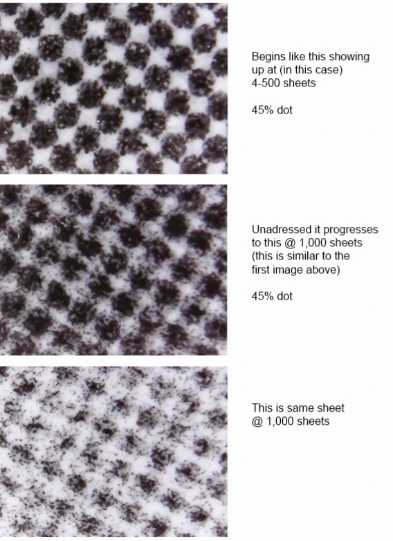

Here's another sample of the problem as it progresses. bottom image is @ 25% dot

Using Kodak Sonora XP, on press develope/cleared.
The same plates will produce excellent dot after problem is fixed.
It is a press problem, operational, not mechanical.
