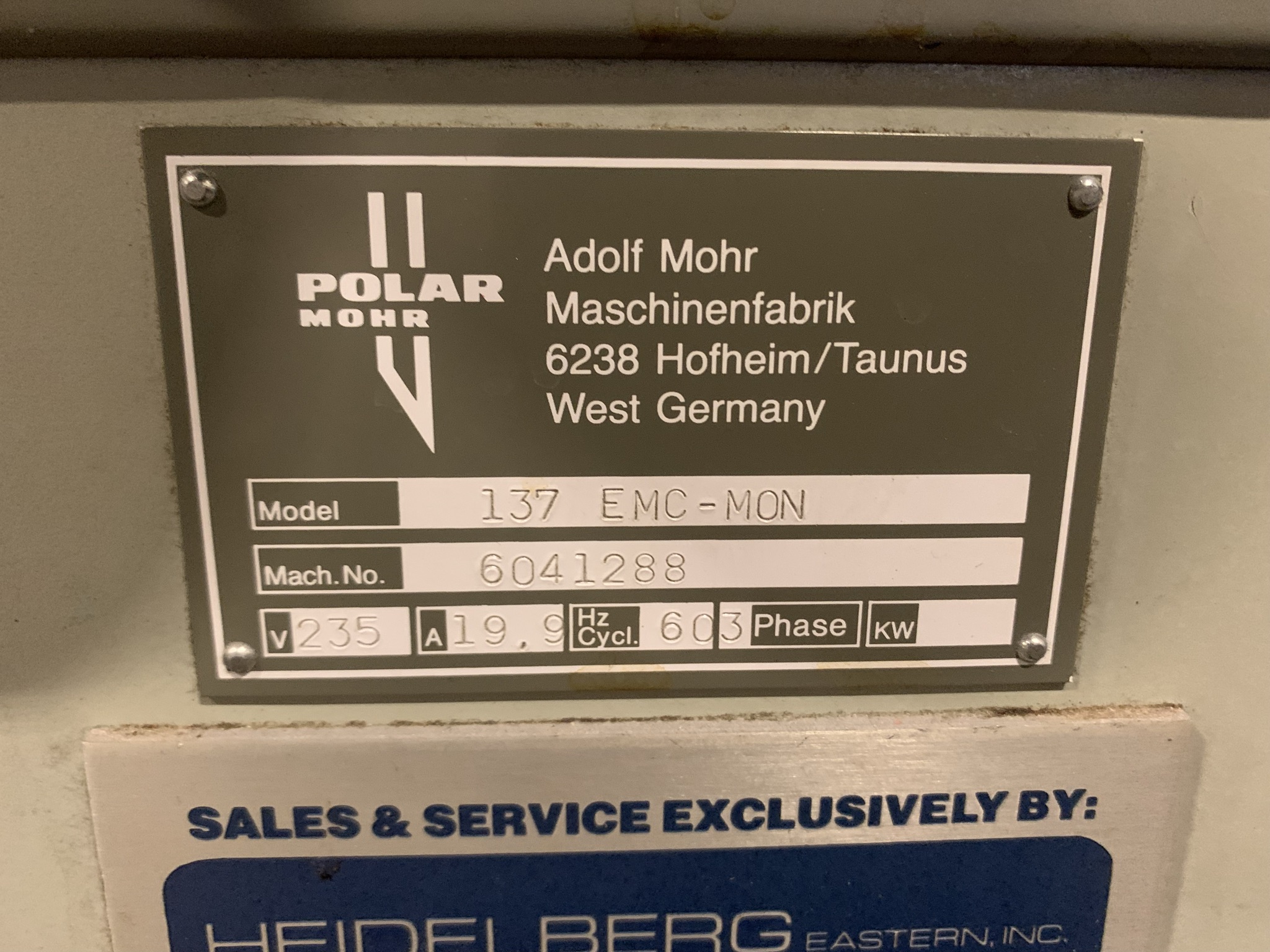

I am looking to find any kind of info on this model of cutter. We recently received it from another branch of our company that shut down and all they gave us was the operation instructions. They also cut a large number of wires through the machine before they sent it to use. We have been able to fix the wire but now we do not have any control power throughout the machine. the main motor comes on and we have power going into the main transformer board but we have nothing coming out. If any one has access to a service manual for it or has any info on this model that would be great.

Look for a green button next to the main Switch, That brings in the lower voltage to run backguage and cut buttons
