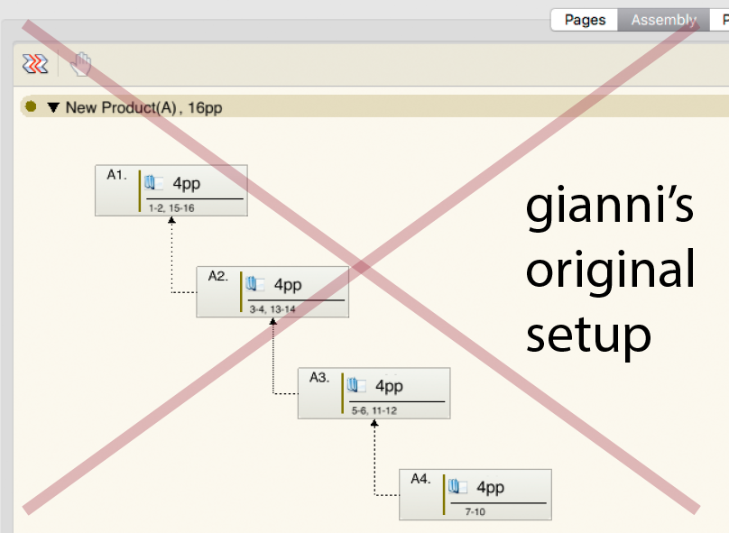

I ask for your help, I am going crazy on little detail in a job.I have a 160pages job. This should be divided in 10 signatures. Each is made by 4 pages printed on a Xerox on 4 sheets.
My question seems easy (if you know the answer): How to put the collation mark on the first sheet of every signature?

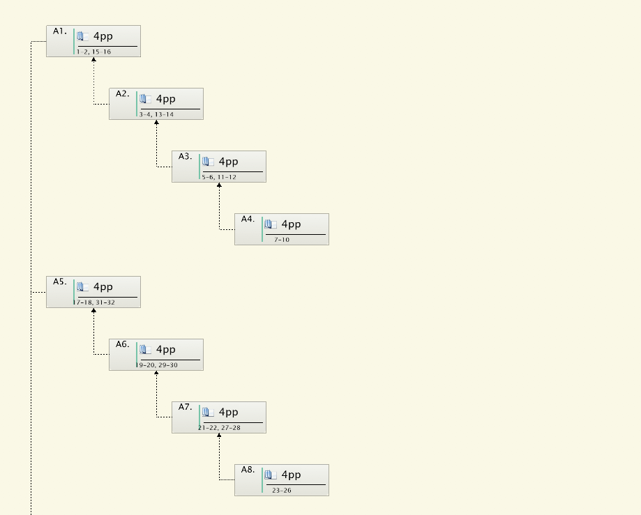

Details: Signature A1 to A4 are binded like saddle stitch, same for A5 to A8, A1 and A5 are perfect bound. I need to place a collation mark on A1 and A5 spine.
The only solution found is to place it manually, but it produce a "hole" among A1 and A5. And that is not suitable for the person who is going to tie up all together.
It is very frustrating… Thanks for every help and hint you can gave me!

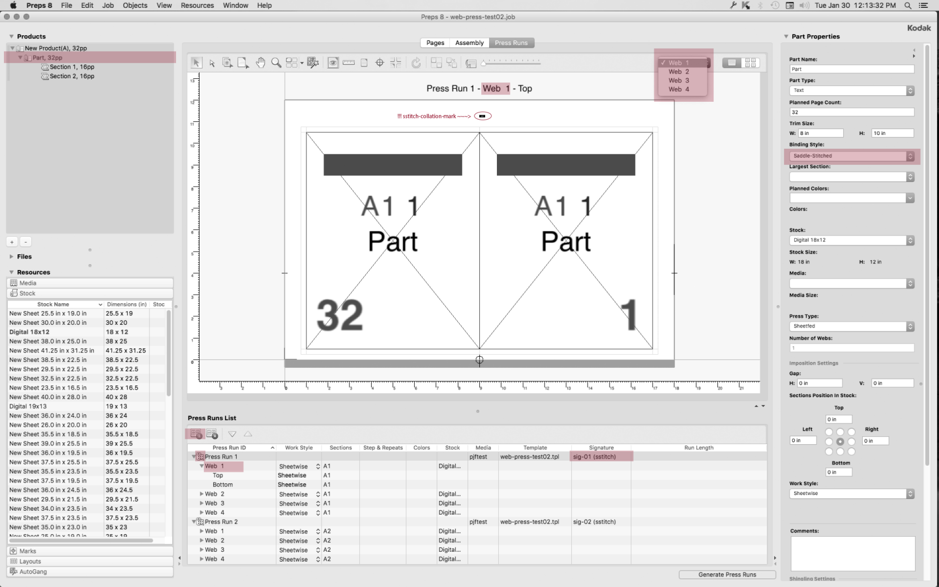

compose your first 4pg in the "press-runs" view/tab of preps (7.1-8.0). at this stage, you can designate that 4pg setup as sstitch (saddle-stitch). directly below this interface is the "press-runs-list" (also known as 'summary-list') … which includes green(+) and red(-) icons (duplicate/delete) on a submenu-bar.
you are wanting to interact with the green-icon … but, before you do, depress the CTRL key on your keyboard … allowing you one of two options ('duplicate-as-web' & 'insert_new_web') … choose the former. once you have 'duplicated' the 4pg setup … it will appear in the press-runs-list with different style icon. down-arrow that icon … you will realize web-1 and web-2 within press-run-1. perform this sequence two more times (within press-run-1) … you should now have 'four' (4pg)-webs within press-run-1 … totaling 16 pages.

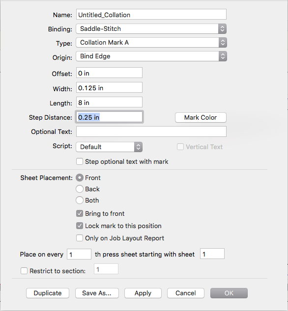

time for the collation-mark. highlight web-1 within press-run-1 … create/apply collation-mark as necessary. for sstitch, remember to utilize collation-setup for sstitch … this is done in the resources-newmark-collation-mark interface (binding drop-down field). click apply/ok and the mark is applied to only web-1. if you wish to apply that mark on one of the other webs within press-run-1 … do so using copy/paste principles.
you already have press-run-1 which contains web-1-4 (16pg total) … follow the same procedure for all ensuing press-run(s). dbl-chk the pagination within each set … proceed to making *.pjtf/*.jdf/*.ps file.

  1. you may copy/paste your first collation-mark to the new press-run-2 which contains another four webs … the collation-mark will advance it's numerical indicator. when changing binding … remember to change the binding within collation-mark configuration as well.
