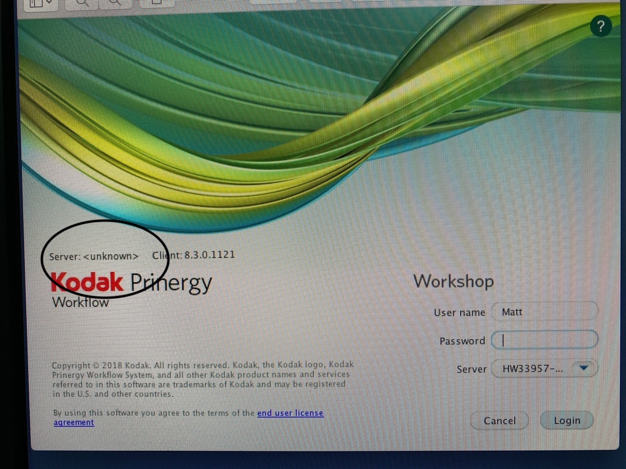

Hi all! I’m hoping you have a solution for this. They moved the Prinergy Server to another area and tried to use a switch to add more computers to the port. Everything worked fine up to the point of starting the Client. The Workplace software reads “Server determining” and “checking for updates”. After about 5 minutes, it changes to “Server <unknown>” and the checking for updates changes to login. However, I try to login and it says I’m not synchronized. Any thing I can try?
Can you ping the Prinergy server from the client machine?
I am able to access the server with no problem and see all the files. Also my Preps and VPS work. Just not the Client. I know I can ping the Prinergy server from the other server. (I run both Prinergy and EVO). I also installed the Workplace Client on a PC other than my Mac and got the same problem. I just keep getting the sync error.

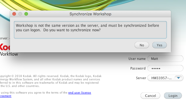

Really don't understand this...it asks you to synchronize with the server, yet if you click yes, all it does is reinstall the Workshop Client FROM the server??? There's no other options....
That is correct, the client needs to be the same version as the server, if it's not, then the client needs to be updated to the server version, this is what it means by synchronisation.We had a situation a few years ago where one particular Mac would always say it was out of sync with the server, I think we had to mount the Prinergy volume first, then run the client.
That could sometimes fix it.
