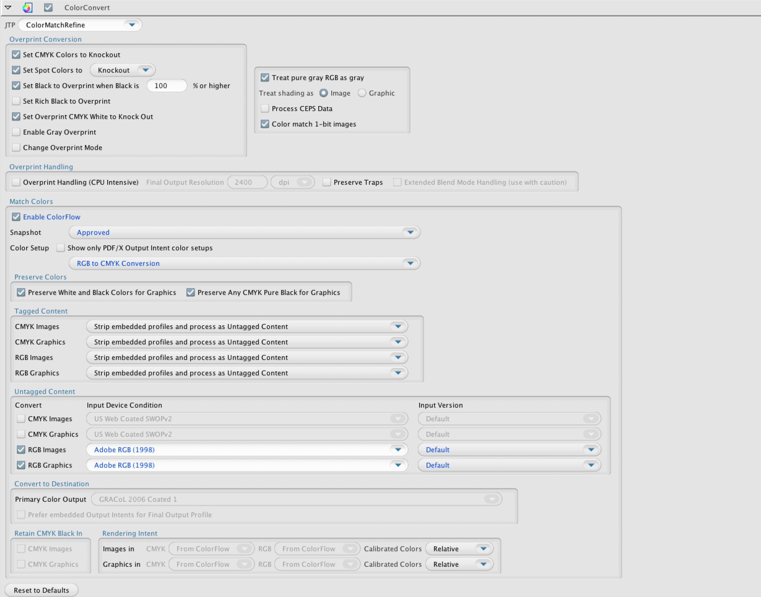

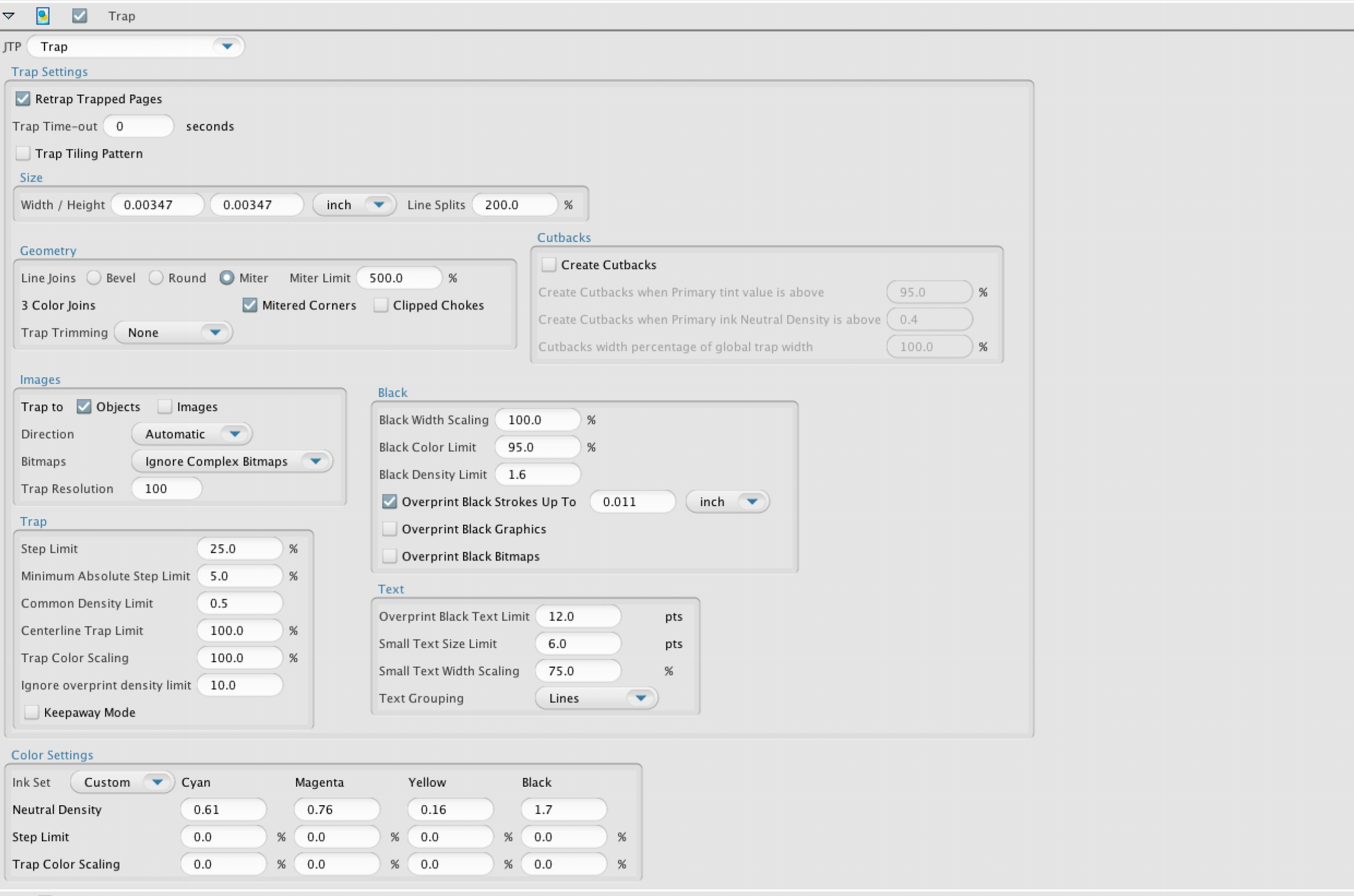

Would someone be willing to share a screen shot of their ColorConvert and Trap sections within a refine process? I have been testing some settings and would like to see what someone else is using. Thank you!
I know this is an old post but if your still interested it what others are using here ya go.

Click image for larger version  Name:	ColorConvert.jpg Views:	1 Size:	1,009.0 KB ID:	265594
Click image for larger version  Name:	Trap.jpg Views:	1 Size:	743.6 KB ID:	265595
As requested. The Color convert section may need to be adjusted for your output. We use ColorFlow which alters the setup quite a bit. If you are not using it you will need to change the "Tagged Content" section to use your desired settings.
