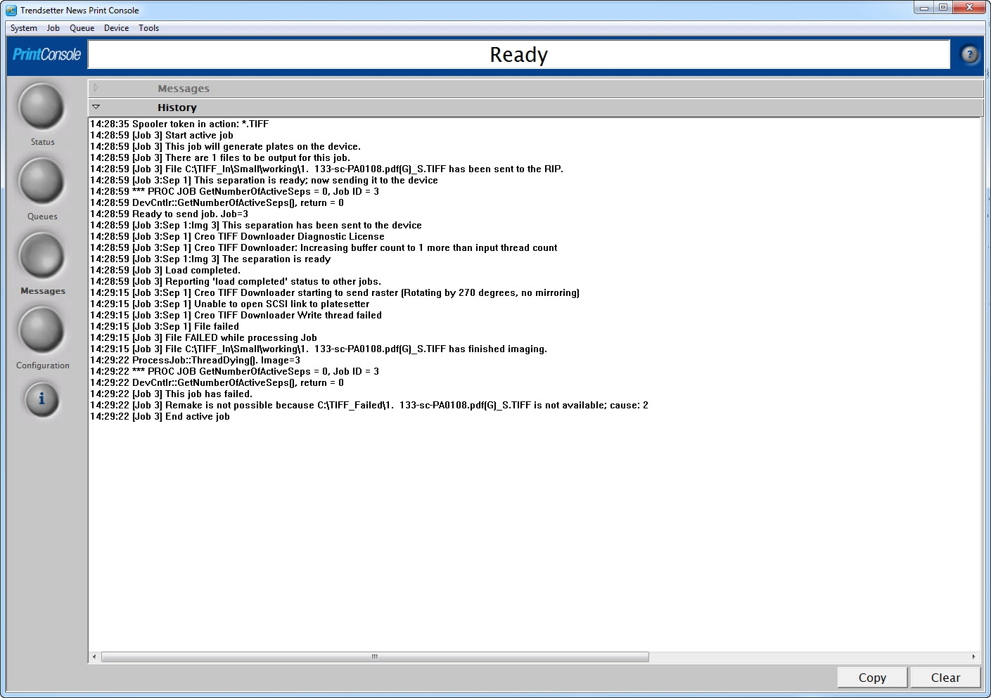

I was able to install Print Console 4.7 on a new Windows 7 station, but I am getting an error that it is unable to open SCSI link. Message attached.
Any ideas?

I guess you meant 2.7 but does not quite work that way...
You need proper SCSI card with proper drivers and the CTP firmware needs to match the rest of the software..
Xitron has a new USB-SCSI interface with 64-bit drivers for Windows 7 and Windows 10. Maybe a Xitron dealer could help determine the compatibility?
You have to run the Console in admin mode. In order to do it, right-click on Console icon and select "run as administrator". Make sure that you have proper drivers for your SCSI card loaded into the systems.
