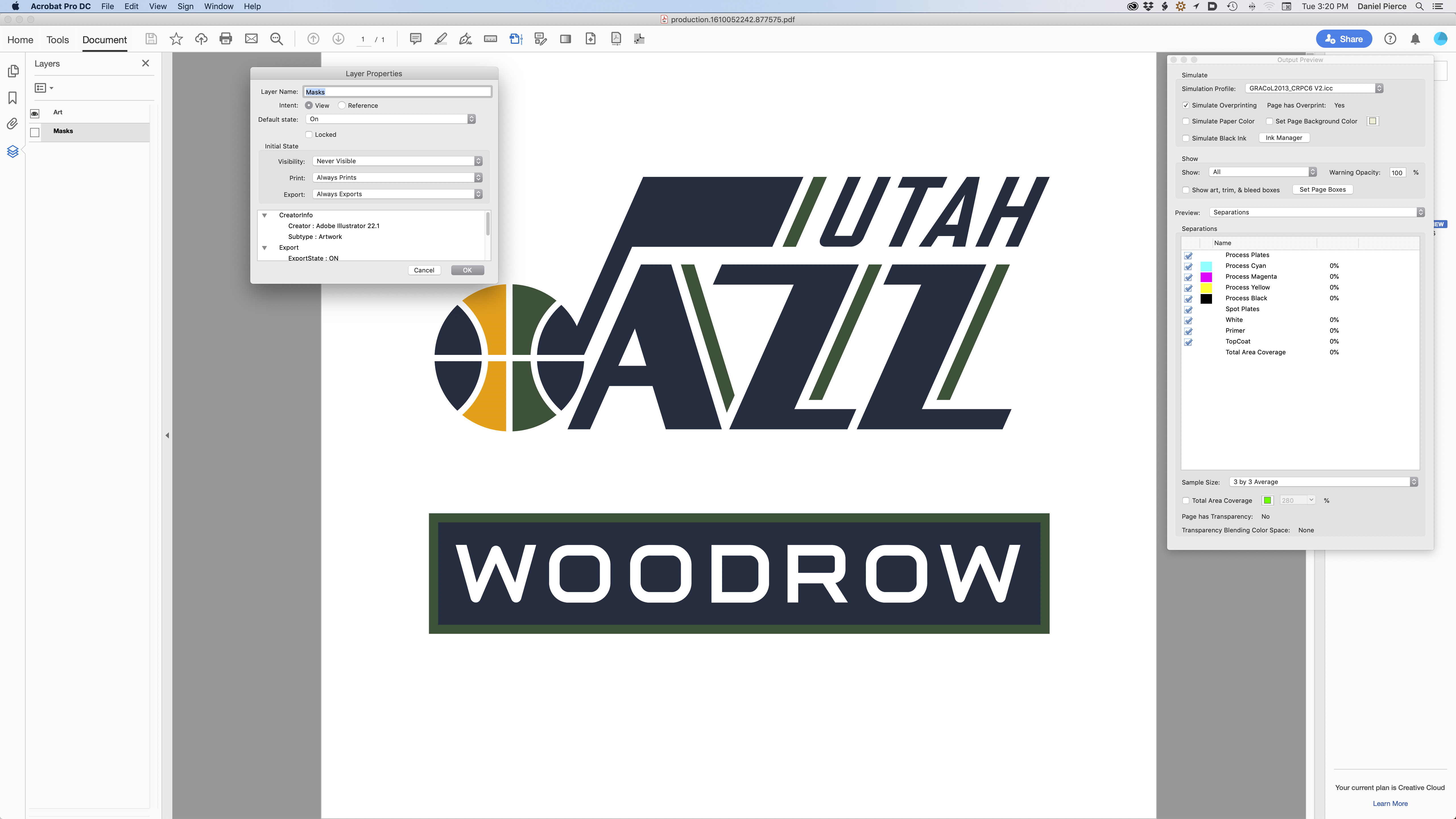

I'm not aware of a rip which will wrangle that problem for you, it may be out there though. You could fiddle with the files in other ways, like keeping the Primer, White and Topcoat on separate layers and then simply turning those layers off for viewing but leaving them on for print. Again, file fiddling. One way to do this automatically may be via PitStop Pro / PitStop Server. If PitStop Pro can be made to create the needed objects/separations/OP status, PitStop Pro can be set up to monitor a hotfolder. Build the files art only and after soft proofing, drop them in the hotfolder for the addition of print seps. I'll try it out in the trial version of PitStop Pro. It might be helpful if your utility separations carried a light tint of color.
I think I smell money - burning.

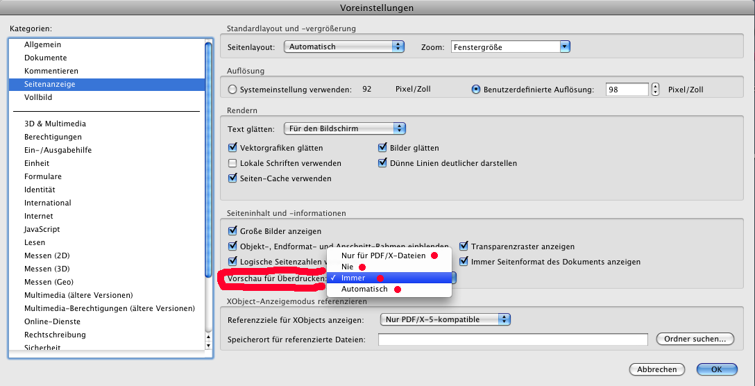

Either you have to communicate the overprint preview in Acrobat with the customer, which I would recommend, or you can send a screenshot for a softproof as the simplest variant, if the content-related completeness of the reproduction is to be approved ...
To honour the overprint-mode is no problem for postscript-based or APPE-RIPs , but for a lot of office-placed printers with RIP´s whithout this ability the chance is really high to get an incorrect print from them.
Or you can make pdf file as pdfx2001 - acrobat reader/pro will show those with overprint preview on by default
take care: this depends from the affected preferences-settings either in Acrobat Pro or Reader by the customer, by doubts that is to communicate whith the customer, too:
and by the way: there are some other apps to show PDF whithout any ability to honour overprint settings...

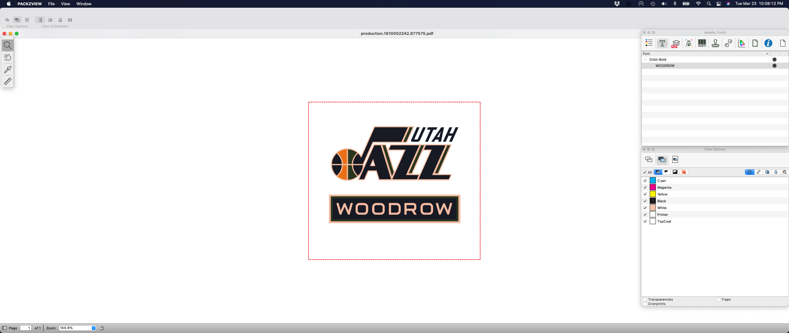

I would suggest you download the free version of our PDF editor Packz, called PackzView. This will always show you what any PDF rip will create. No need to worry about overprint previews. PackzView understands the PDF structure much better than other free viewers.
PACKZVIEW
Attached is a screenshot of what I see on your file without having to change any preferences.
