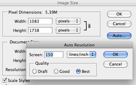

When resizing an image in Photoshop using the image size command, there is the "auto button" - which works with lines per inch or cm and uses the common x1.5 or x2 quality factors (screenshot attached).
EDIT: This command is intended for use with a traditional AM halftone screen on a printing press, not an inkjet printer (inkjet FM screening is more forgiving of lower resolution input).
