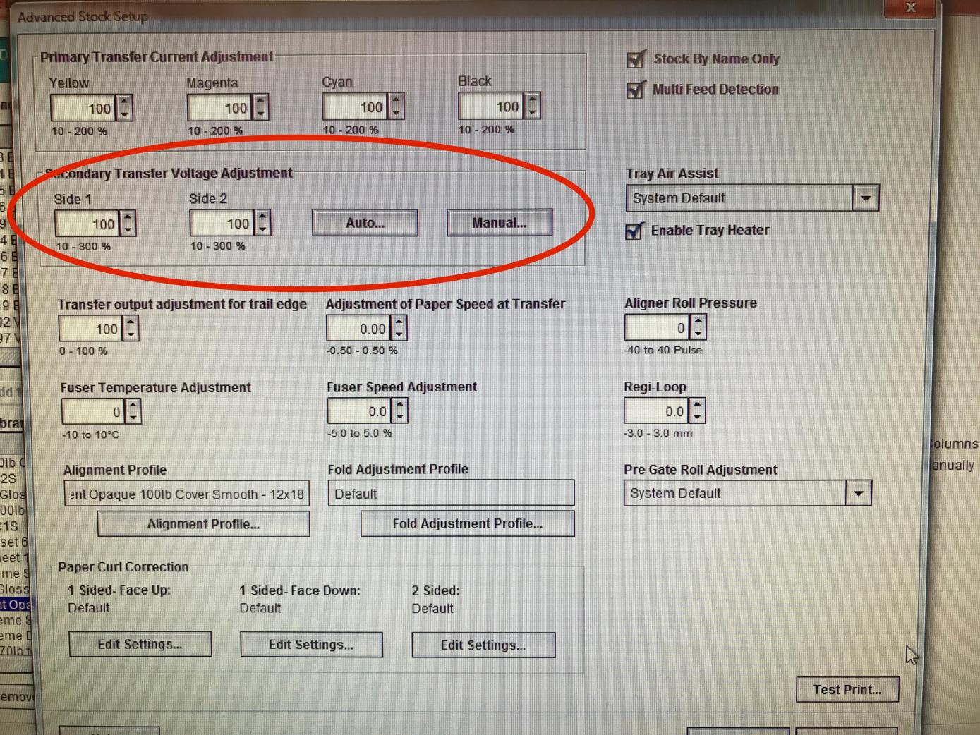

Did you try using the "Secondary Transfer Voltage Adjustment"? This is the only thing that has helped with textured paper and I believe is exactly what it is meant for to get the smoothest image on any stock. I run it seasonally or anytime I start having image issues with solids.

Where is this screenshot coming from?
Thanks for the replies... very helpful... I have been adjusting the Secondary Transfer Voltage Adjustment for various stocks in the past and it works ok..
I tried adjusting it to a ridiculous value and now it prints fine. so rather than it being on say 70 or 80 as an adjustment.. I am using 30-35 . This slows the fuser right down and gives
an acceptable level of print... The downside is that it wont do Duplex at this speed on this stock. That isn't a problem in itself ...just slows down production.
This screen shot is from the Stock Library Manager.. Goto Stock Library Manager.. Click on Stock Library.... Click on any stock... Click on Properties... goto advanced set up and the Secondary Transfer Voltage Adjustment is
the second section form the top of the page...
