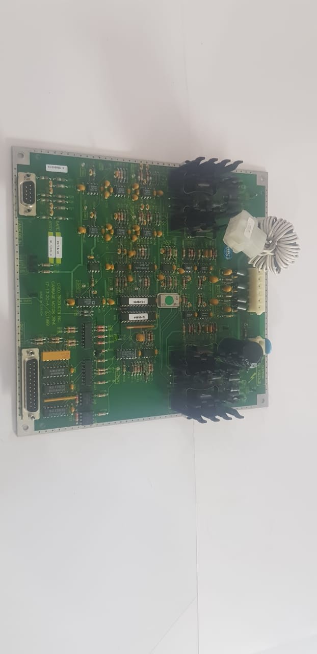

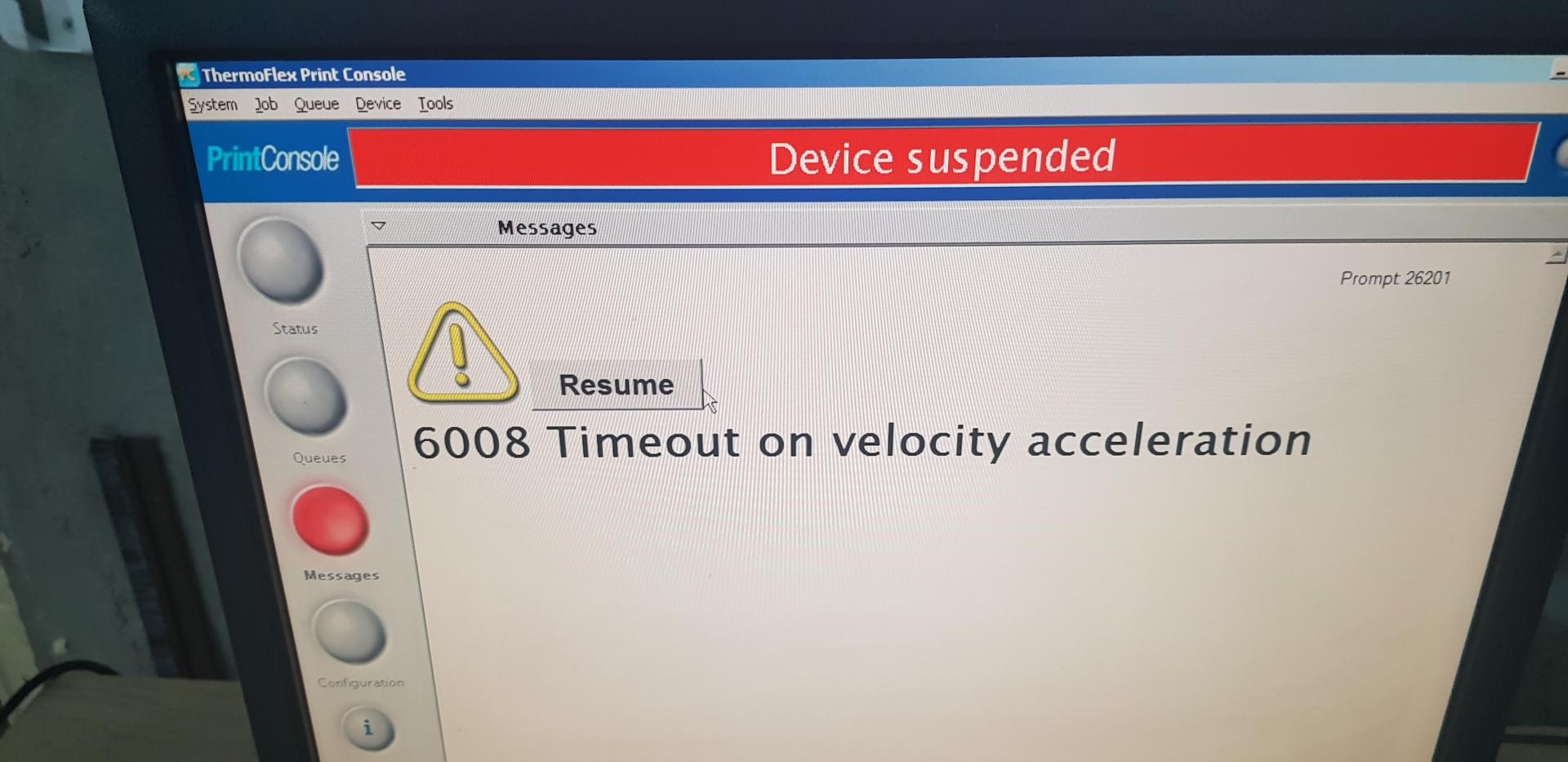

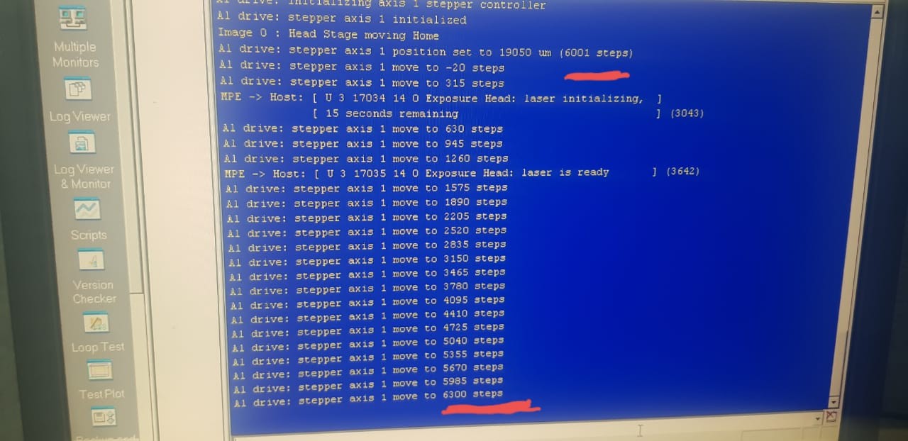

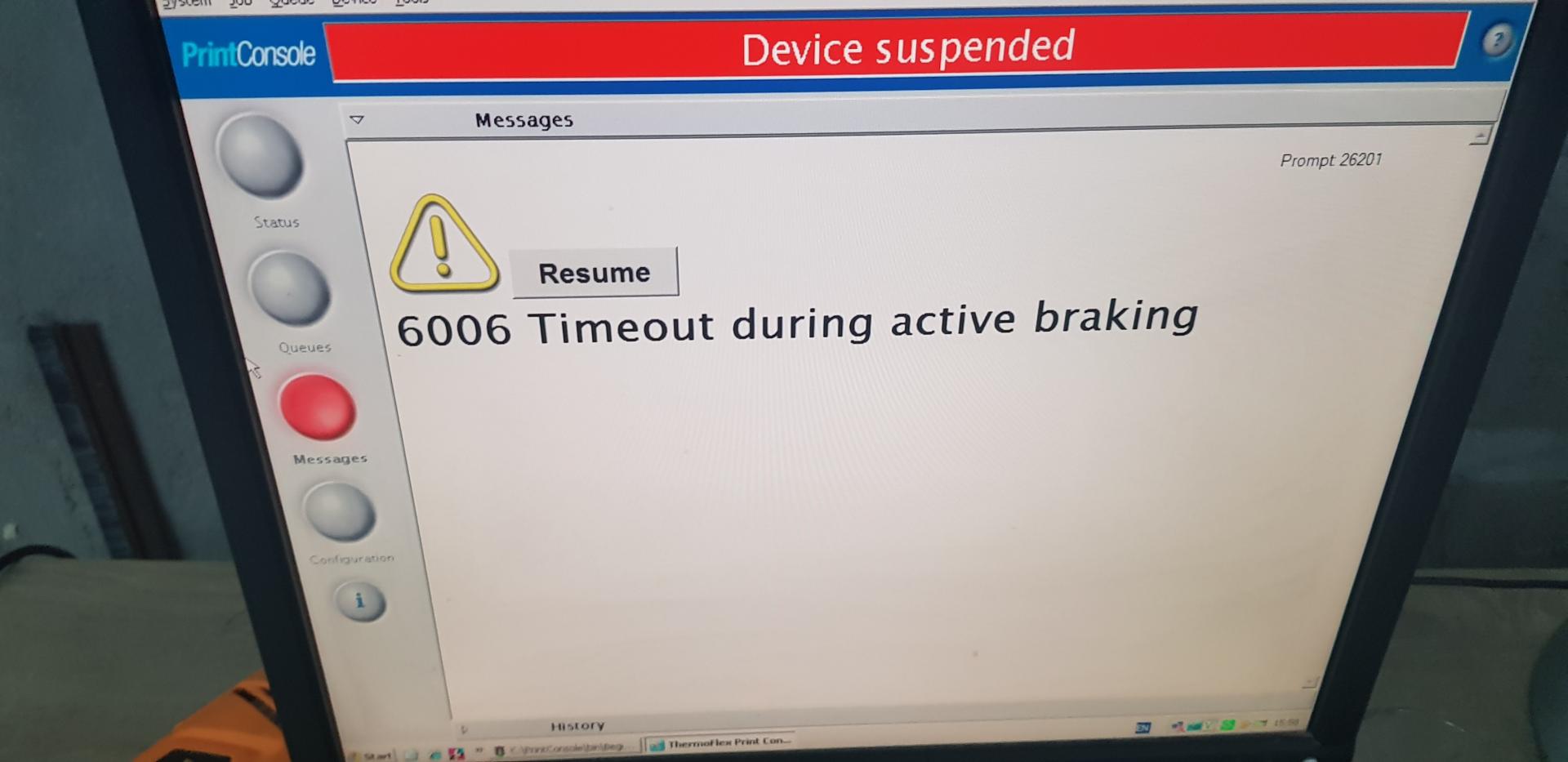

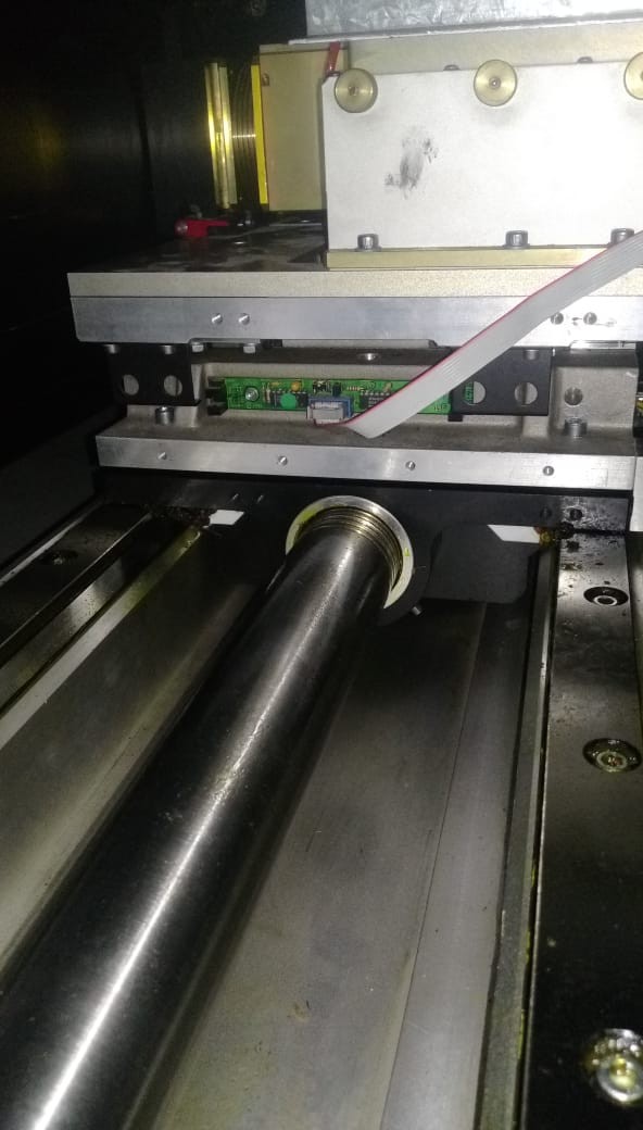

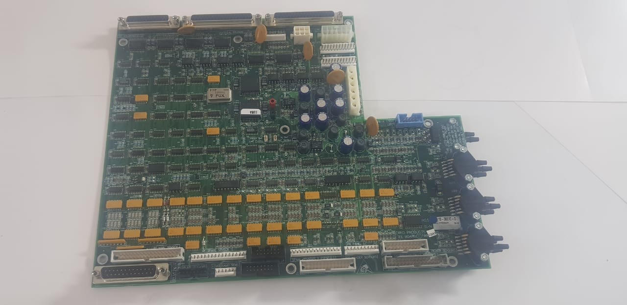

problem initializing carriage motor thermoflex wide l kodak

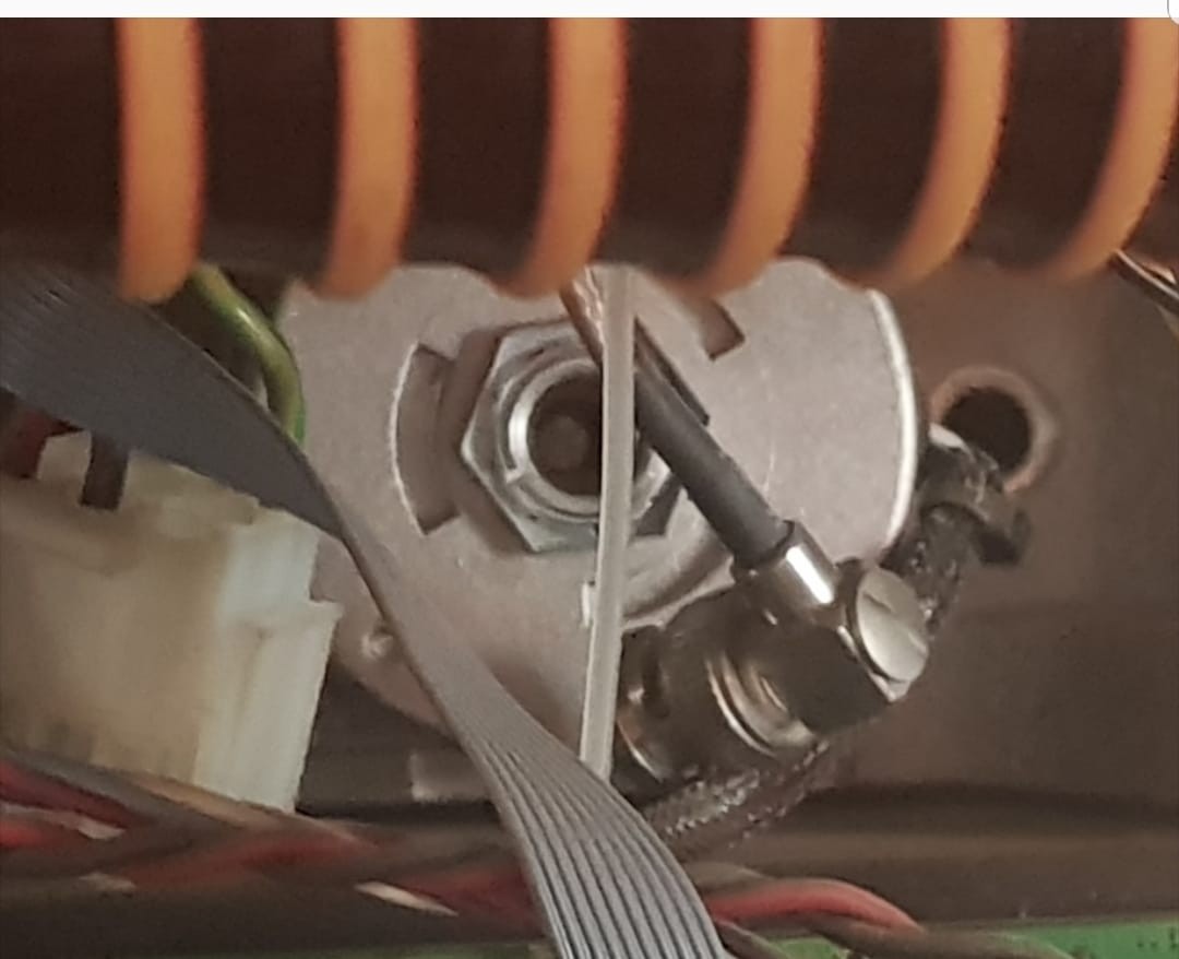

mustafaomara90

you must provide more info in order to have a better understandimg of the problem.
Error #?
Give a detailed problem description.
Regards
Hi
please send me another link where I can see the video. I have not been able to see it at the shared website link.
Regards
Hi
definetely not enough info to help you with the video.
I need more detailed info.
Printconsole error #?
Access to serviceshell?
Why are you troubleshooting the equipment without all neccesary info?
Without that info I can't help you
Your problem could be related to
1) carriage motor encoder problems.
2) Carriage Driver Board Power supply problems
3) mpe board nvs settings
You need an specialist to help you out to trouble shoot this problem.
Regards
AFG
Hi
​​​​​assuming that your nvs parameters are OK . check your drum.encoder,
1)check voltage at the input of drum driver
2) clean the drum enconder band
3) do a drum cal command
Regards
