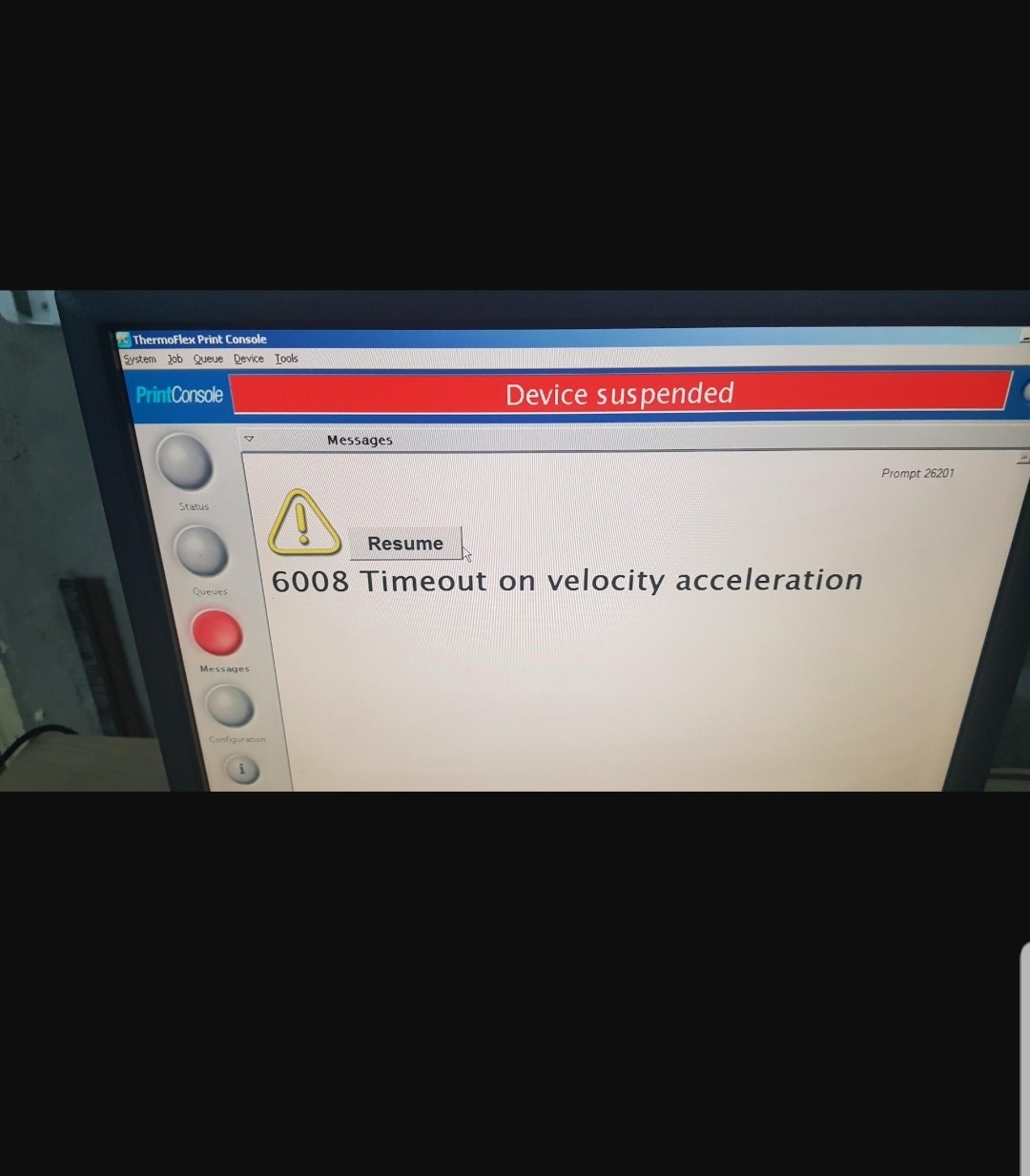

nemo tihs is log and error
  • device_2019_05_30.log.docx
Clean the encoder disk thoroughly.
If that does not fix it you will need a new drum amp or motor.
