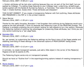

I had trouble with a file (38 pages) made in Indesign CS5.5, with fonts downloaded from internet or something, I think its a fonts problem . I need to manipulate the PDF in illustrator, but if I create outlines in Indesign will loss atributes like the gradients, underlining, strikethrough, etc.
and if I export to PDF from Indesign without create outlines, some fonts and font atributtes disappeared when I open the PDF in Ilustrator.
Looking in the web for advice, I finded that I could outlining the type and preserve its atribbutes by flatening during the printing process. (I Attached a pic explained this)
Perhaps I so wrong with the interpretation, the thing is that I want to outline type without use create outlines in order to preserve type attributes created in Indesign.
Hope I explained myself.

This has been stated many many times before... Illustrator is NOT a PDF Editor. If you are having a problem with the fonts, don't try and work around the problem. Solve the problem by either going to the font manufacturer or Fix the font with a Font Utility from Font Labs.
Also, when working in Indesign, don't print to PDF but use the export as PDF option. This gives you far greater control over your PDF output.

The Adobe PDF Printer for Mac OS was actually removed in Acrobat 9 due to changes in Snow Leopard. It was replaced with a "Save as Adobe PDF" button in the PDF Workflow area of the Print dialog for use with non-Adobe applications. Adobe apps, as already mentioned, know how to create Adobe PDFs directly.
If you must outline the fonts, why not outline them in InDesign before exporting to PDF? It may be a case of bad quality fonts where points are too close in which case you can "cheat" by placing a transparent object over the fonts (e.g a 99% registration mark color set to screen blend mode) And export to a PDFx1a, that would force the visual appearance of InDesign to be maintained (at the price of 100% colours being 99% which in most processes will be invisible due to dotgain)
