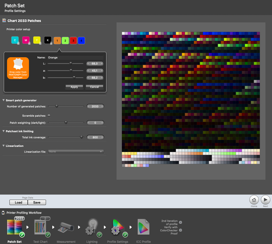

I'm currently helping a student profiling his printer Canon imageprograf pro-300 with Xrite i1profiler and an 'i1isis 2'
the software is giving me the possibilities of creating a profile for CMYK + 4 inks.
The printer the student is using uses the following combination
Y/M/C/R/PC/PM/Gy/PBk/MBk
Can u let me know how I need to insert the LAB values in the software according to the printer inks ? I'm a bit confused

Dear Bteifeld
You are right, the person will be printing from a macos and without a RIP.
thank you for you answer but the question about the LAB value is still puzzling me..
For your specific situation, under macos, you should have no need to
fill in LAB values in i1profiler. You should be choosing RGB.
If you were using a RIP where you were using i1profiler to provide the
icc profile, and you were working with a printer with extended gamut
inks like orange, red, green, blue, and/or violet- you would print a
non-flooding 100% patch for each of the extended gamut inks,
measure the L*a*b* in each case, and use that value.
You could also just choose pantone L*a*b* for the pantones you
felt matched the equivalent of the 100% patch for each extended
gamut ink.
