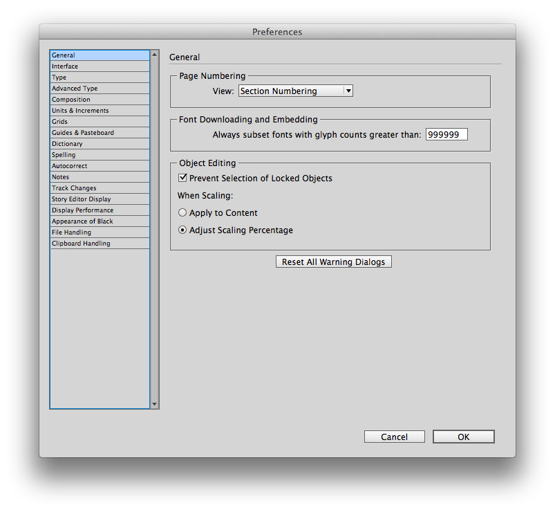

Page 5 - The font embedding threshold in this pane is an attempt to get fonts to embed in their entirety. There is a preference that must also be set, or subsetting will still occur.

With regards to font embedding, there is absolutely no way to force InDesign to fully embed any arbitrary font within an exported PDF (or even EPS) file, regardless of any settings in preferences or this export options pane; i.e., it will work for some but not all fonts!! And quite frankly, there is no good reason that we know of to fully embed a font unless you own stock in Seagate or Western Digital (or perhaps Maxtor or SanDisk for SSDs). Full font embedding does not enable PDF text editing in Acrobat Pro or (not recommended) Illustrator without the font being installed on the user's system. And contrary to industry bubbameises, neither subset embedding nor full embedding yields a PDF that is somehow more reliable for rendering.

As to font embedding, PitStop will allow you to edit text with embedded characters. So, getting the whole font can be useful. Unfortunately, an embedded subset of a font only includes the characters used. It would be cool if subsets could include all glyphs from the language of the document.

"With regards to font embedding, there is absolutely no way to force InDesign to fully embed any arbitrary font within an exported PDF (or even EPS) file, regardless of any settings in preferences or this export options pane; i.e., it will work for some but not all fonts!! And quite frankly, there is no good reason that we know of to fully embed a font unless you own stock in Seagate or Western Digital (or perhaps Maxtor or SanDisk for SSDs). Full font embedding does not enable PDF text editing in Acrobat Pro or (not recommended) Illustrator without the font being installed on the user's system. And contrary to industry bubbameises, neither subset embedding nor full embedding yields a PDF that is somehow more reliable for rendering."
We are using OPS online ordering system and the fonts need to be fully embedded in the master pdf so that the customer can input the information they need into the fields and have the fonts come out correctly . . . so I sometimes wish for an easy option to fully embed a font.

With regards to PitStop allowing editing of text with the glyphs in the font(s) already embedded in the PDF file, as far as I understand, PitStop only allows this for fonts for which the fsType table allows editable embedability. Most commercial fonts simply do not allow this. Furthermore, even when one thinks that they have embedded a complete font, they really haven't, whether it is Type 1, TrueType, or OpenType (or either flavor). Only the glyphs, advance widths, and some additional metrics are embedded. The various font metrics that allow for pair kerning, small caps, ligatures, etc. are not included in what is embedded. The only way to do that is to fully-embed an OpenType font, a feature which is not at all available from InDesign, Illustrator, Photoshop, etc. (and as far as I know, from PitStop or Call pdfToolbox, etc. as well). That makes high quality editing using an embedded font nearly impossible. Oh, and by the way, even if it isn't enforced by applications or PitStop, many font EULAs (End User License Agreements) require that only subset-embedding is permitted.
Actually, Acrobat Pro does allow for absolutely full font embedding for PDF forms if and only if the font is one for which we can ascertain that the EULA and the font vendor allow use of the font for this purpose. This includes a subset of Adobe's font library.
To extend on what my esteemed colleague has said...
It should also be noted that even when a font is "fully embedded" - that ONLY applies to the glyphs themselves. There is ZERO requirement to embed font information that is used strictly at layout time - such as kerning tables, OpenType layout information. For that, you would need to do a SPECIAL TYPE of font embedding, where the ENTIRE FONT is embedded. Adobe Acrobat will only do this in one specific case - when the font is used as the font of a form field - because in that case, it knows you are going to be using it for data entry & edit.
