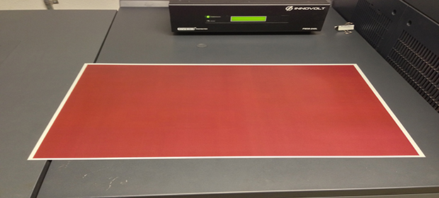

our c8000 just bands constant on 280gsm and above...not a faint line - its about 1-1.5cm wide and stands out like a sore thumb.
would you be willing to do a test for me? Print a 350gsm board with a wine red: this colour:
http://www.abbuildingproducts.co.uk/images/content/Sealants/coloured_silicones/3005_wine_red.jpg
just solid on the sheet and take a picture? I cannot understand how our machine creates a terrible banding line?!
If you could would be great - would help us get Konica to replace this thing of ours
Here you go printed on 352gsm stock.
Not to be fussy but could you get a higher res photo? Just Konica want to get a look here to ensure its not appearing :)
