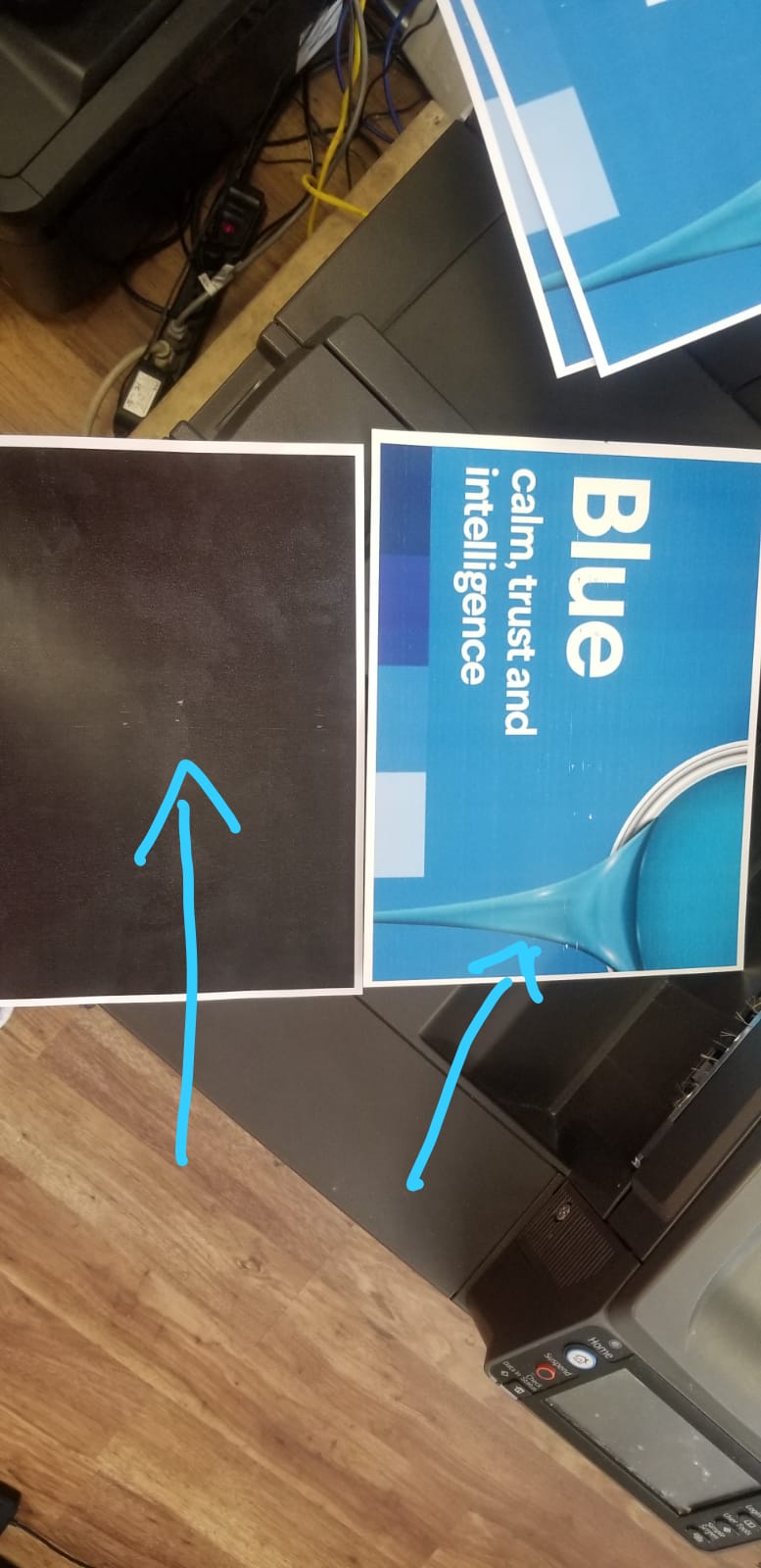

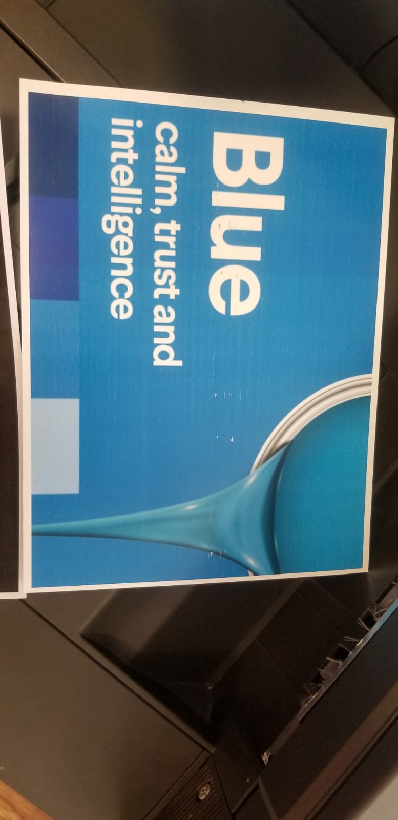

6 6dimensions New member Aug 12, 2020 #1 Replaced all the drums and toners. Still getting this white patches Any idea why this happens. Please advise. Attachments White patch.jpeg 110.1 KB · Views: 393 White Patch two.jpeg 85.4 KB · Views: 376
easiprint Well-known member Aug 16, 2020 #2 Looks like a fuser problem to me. You can see the missing patches of toner being dropped in the white of the word Blue. Scratches in the fuser roller would cause this.
