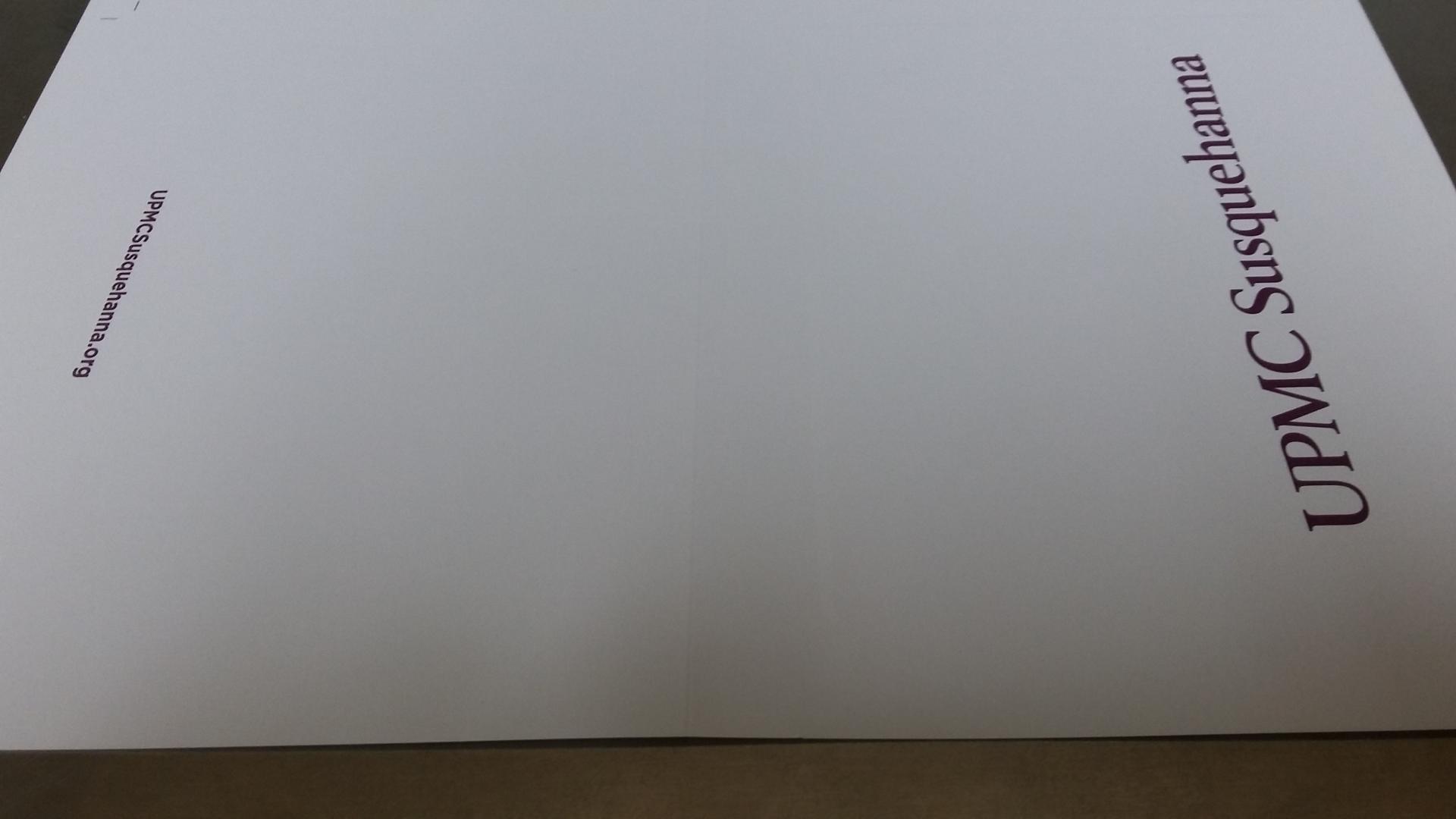

Got a request for a job that would be printing on supplied sheets of 65# uncoated cover, 6.25 x 9.25 and the sheets are embossed, I believe where they are embossed is also the area I will have to print. Anyone have any experience with this? And will it work? At this point I told my salesman I'll have to have a few sheets to test but I'm guessing it won't work. Thanks.

OK guys; test completed and it seems to run with no problems. Tested with 60 sheets and no feed issues and also no print issues. It's really hard to see the embossed area and the embossment is really slight. I think they would be better off having me just print a slight gray screen for an embossed effect rather than this. But anyway it works and I'll be printing this order.
