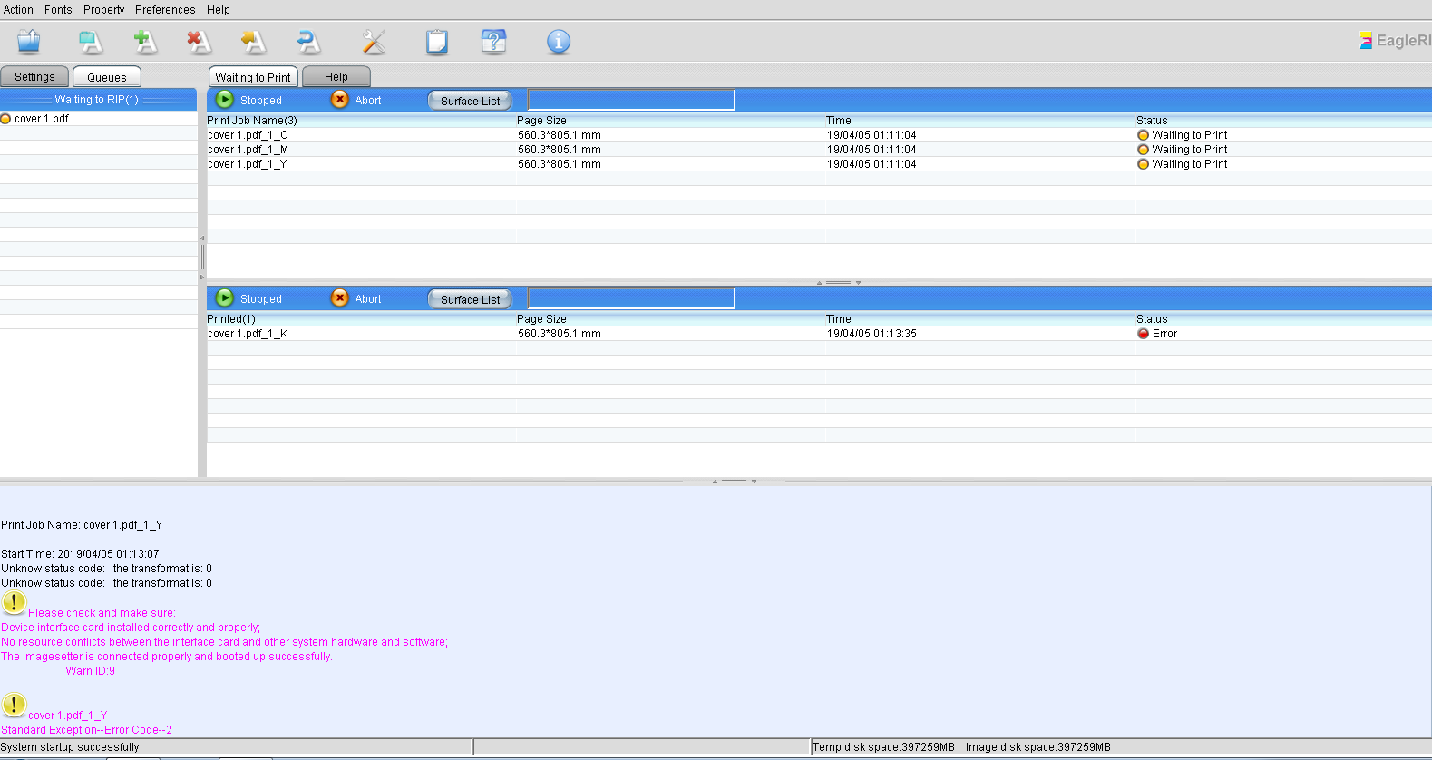

Hello print planet,
I have a PlateRite 8600 and using EagleRip 4.5 on a PC that came with the CTP.
I would like to change the PC because its kind of old and over the years has become extremely slow.
I was able to extract the Interface card (25pin) from the old PC and inserted it in my new modern PC. However after installing EagleRip 4.5 on the new PC, the CTP doesnt seem to pick the interpreted pages.
The Error I am getting is in the PHOTO I have attached. kindly advise on where I am getting it wrong.
Your help will be highly appreciated.

Hello print planet,

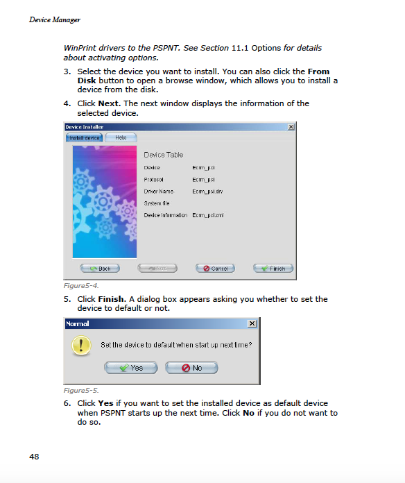

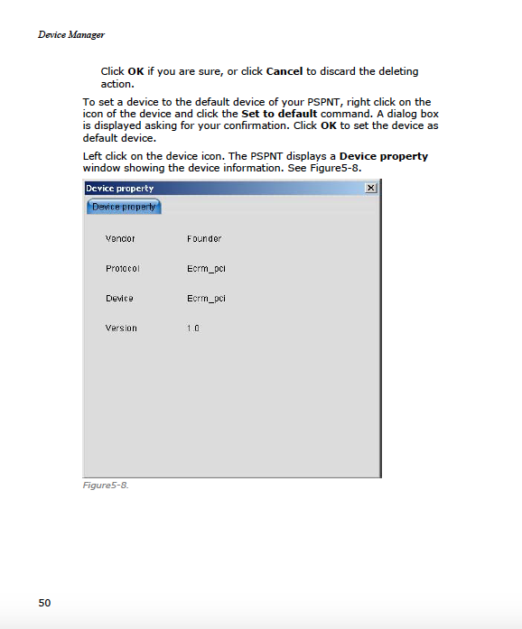

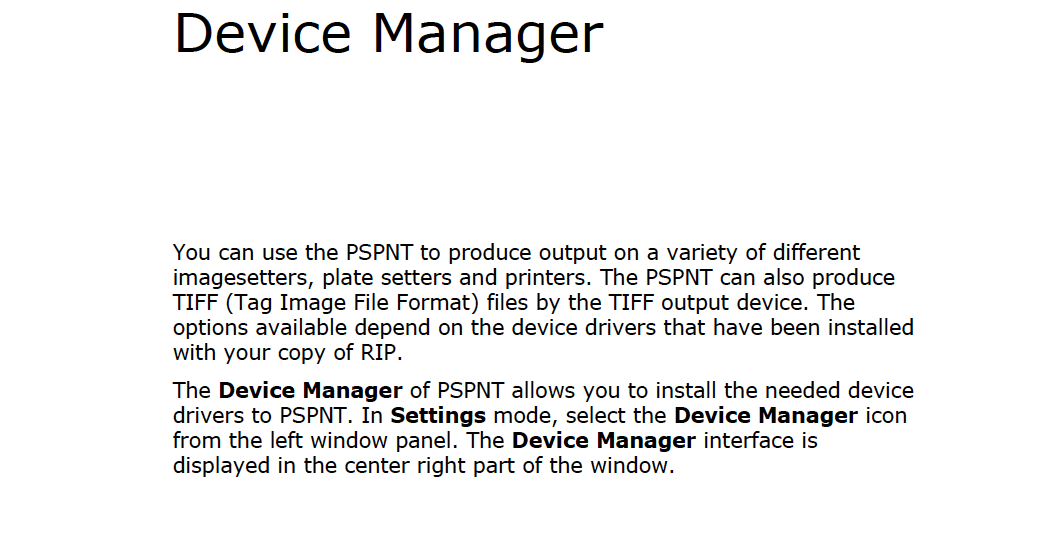

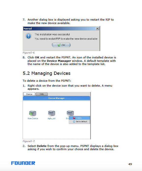

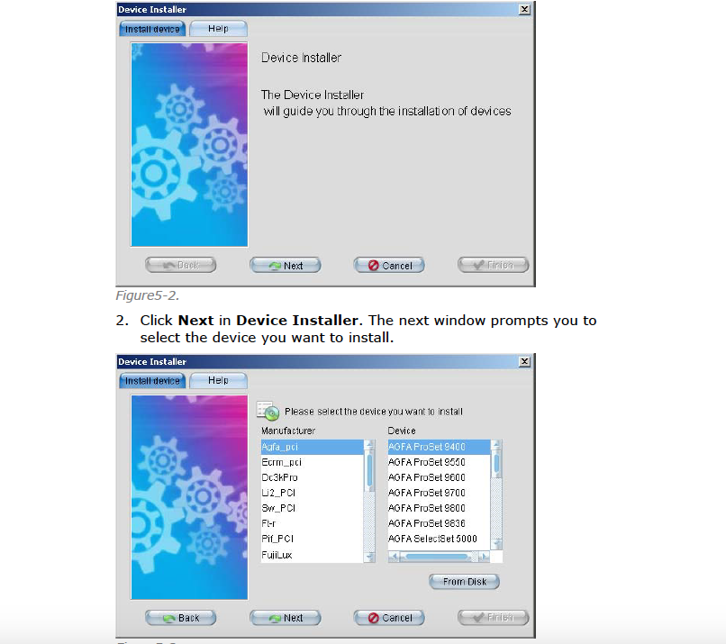

Hello Gills,
This is system requirements for the Founder IF board.
CPU : Intel (R) i7
Memory : 4G or above
Hard Disk : 200G free space
Display : 1024 x 768 Color
Network : 100MB Ethernet
OS : Windows 7/8/10/Windows 2012
I attached some pictures to install device manager. I hope useful for you.d some pictures to install device drive
