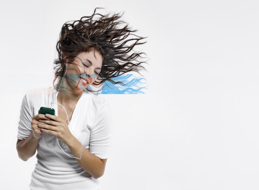

Anyone have any Idea what may be causing this to happen, see attached, Image (Cover_bluewhoops.jpg)

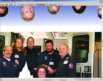

Also see attached (imaged ripped to epson.jpg) for proofing.
We are using CS5.5 Indesign to print, PC platform, This seems to happen about once a month or so when printing a ps. to a pdf, and when printing the Indesign document direct to an Epson 9900.

I've seen things like that occur when saving a file over a network. If there is a hiccup in the communication between your workstation and the server, the data doesn't get written properly.
I typically save locally, then copy to the server. Takes a bit longer, but it seems safer.
I've also seen while a file is being written to a hot folder and the hot folder script is attempting to simultaneously move or process the file.

I looked at your file (in a HEX editor) and it left me with some thoughts (some questions, other thoughts)...
1) Did someone retouch the lower right corner at some point? (i.e., the blue error at the lower, right / sweater+elbow). The "image" within the PDF isn't simply one entity (which it would be if it were actually a single stream). If it was retouched you might verify your practices / network at *that* level of the (greater) process.
2) Please disable Flate coding Distiller/PDF Optimization (for a while) for files like this (makes manually reading files like this difficult). You might also want to upgrade from Distiller 7. I'll have to deflate the data in order to actually determine what form the image stream(s) is(are) and from that one can determine if a resilient data type was employed (i.e., one that maintains integrity from start to end of the data set).
3) There's an all too common "programming" error to copy a file when a move is more correct. Ignoring (for the moment) that end users don't generally see the difference (or know/have access to know) a move operation (and delete) simply changes a file system whereas a copy operation physically copies bytes from A to B. I say this because (aside from being WAY faster) a move will typically fail (rapidly) if multiple parties are accessing the file. It will certainly fail if a file is open for write (but has not been properly locked). Moves aren't appropriate when spanning file systems, however. You may also add a verification step to any copy operation (e.g., MD5 hash A and B and if the hashes don't match the copy operation failed regardless of what your "program" indicates).
