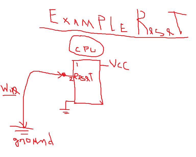

Did you test my steps that i did recommend you??
I am attaching schematic how to Reset the Cpu.
Blessing
[email protected]
Yes we are able to reset and then the error goes away but then comes back again and every time the machine has to be stopped for the computer to be reset/reboot. I am trying to find a way to upgrade the computer to a new off the shelf computer.
