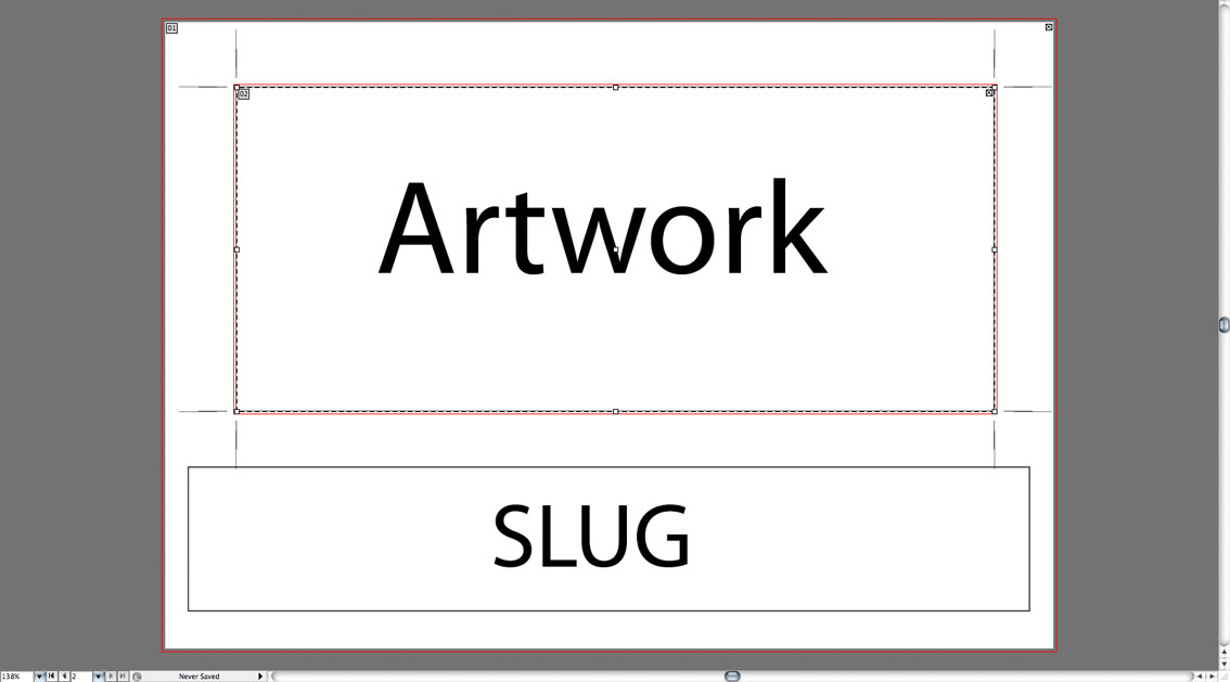

Hi guys, its possible in CS4 / CS5 to have artbords within other artboards, for instance I use artbord 1 for the actual artwork (complete with bleed) and I draw artboard 2 around artboard 1 and use it for slugs and other non printing objects. The advantage is that I can save to pdf or print just the artwork minus the slug, or the artwork with the slug as need arises. I have attached a jpg screenshot (I hope it has loaded) to demonstrate the two artboards of one document. Let me know if it works.

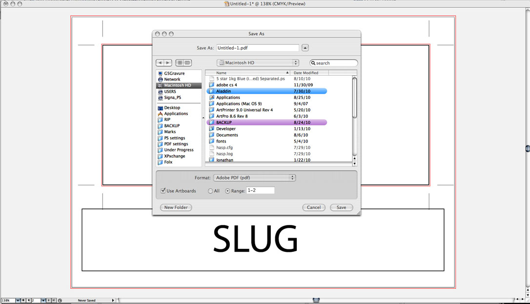

When you save to PDF etc, you select the appropriate artboard(s). In the attached demo I choose to export artboard 1-1 ( choosing to export 1-2 will give me 2 PDF pages).
