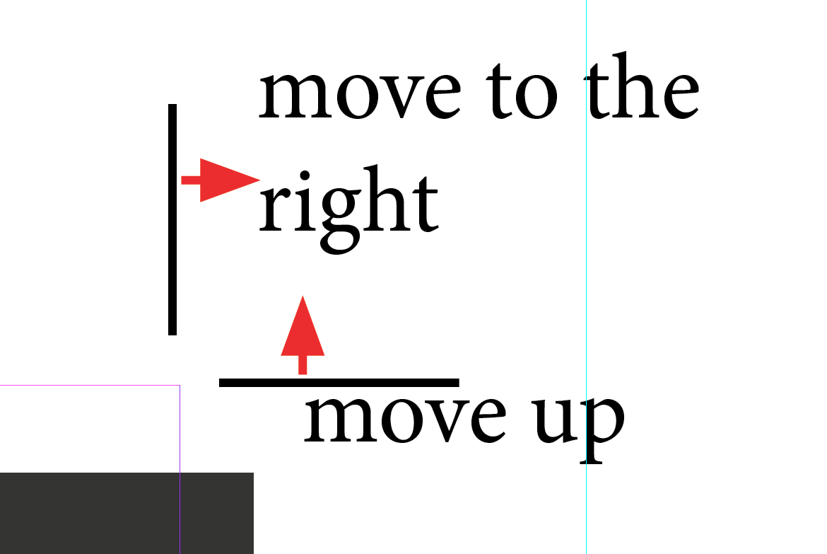

Pdf created in Canva. (supplied by customer)
Is there a quick way to move these in adobe acrobat? (see attached, this screenshot is not from the actual file). I don't want to open the file in illustrator (for obvious reasons). I could do it in pitstop,
keeping in mind I have a very old version and I don't find it the easiest to use. I can easily move them as a whole but can't move one trim one way and the other trim the other.
I don't want to throw back to my customer. (Agony to get the file to the stage it is).
Any help much appreciated. thanks Simon

That said, i think an easy way out would be to simply select those trims and remove them. Then add new trim marks based on your liking.
I am pretty certain even old versions of PitStop would help here.

You get the Canva file and think yay:) I've got cmyk and Trim Marks but the Trim Marks are fat and sit one side of the Trim Box, and the Trim Box isn't centred usually a slightly odd integer size and not centred :(:mad::eek::cry:, for saddle stitched you're still expected to apply scaled creep to this poop.🥱

Indeed PitStop would help. There are the canned actions "Remove Printer Marks" an "Add Marks to Trim Box".
