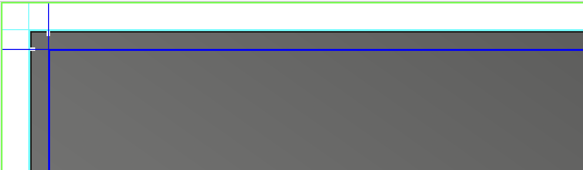

See the following example (here is the top left corner of the PDF file):

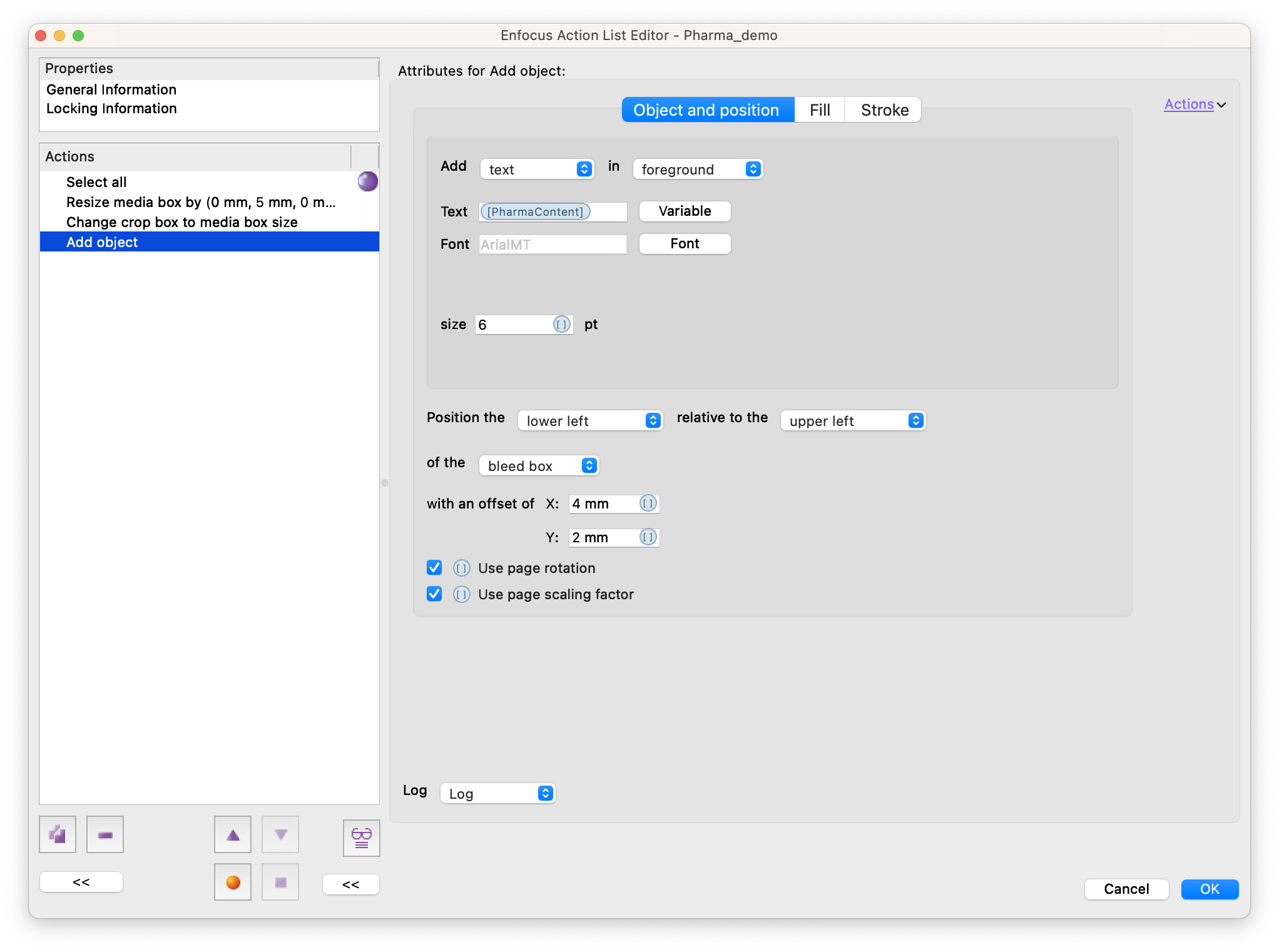

All we need, is 3 basic instructions:
- Edit Mediabox (just extend top dimension)
- Edit Cropbox (not mandatory actually but more comfortable for visualisation)
- Add Text Object (we are using a variable here: "PharmaContent").

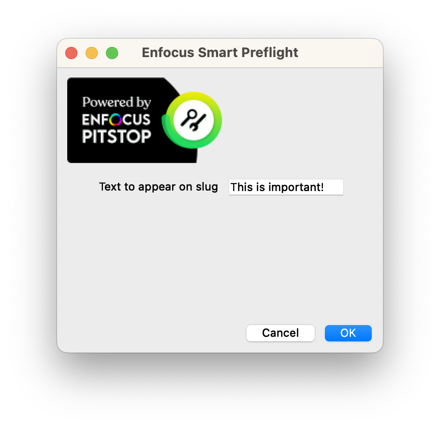

Now, we just run the action list. This will ask for the text to be displayed (if you need something dynamic)

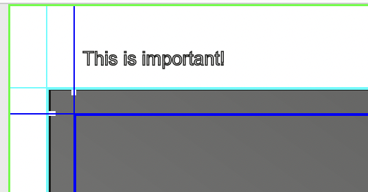

And then the result:
Couldn't be easier.

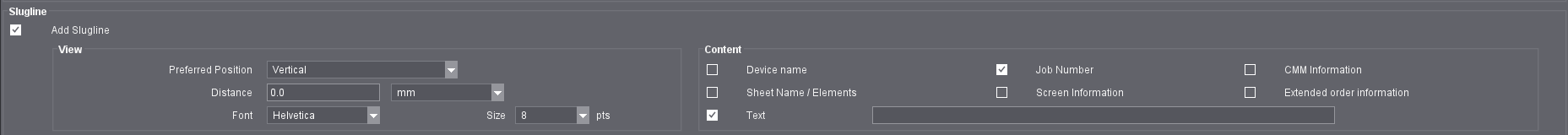

I mean if you are using Prinect, you should use PDF Proof sequence and it can add slugline automatically to the created proof pdf.

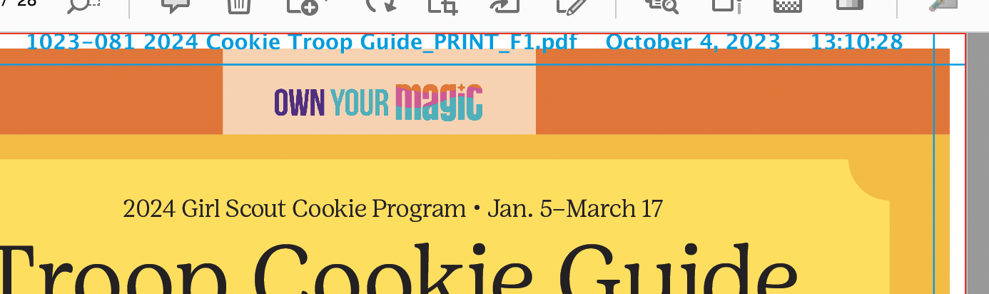

We use a PitStop action as well. You can set them up to do virtually anything.
