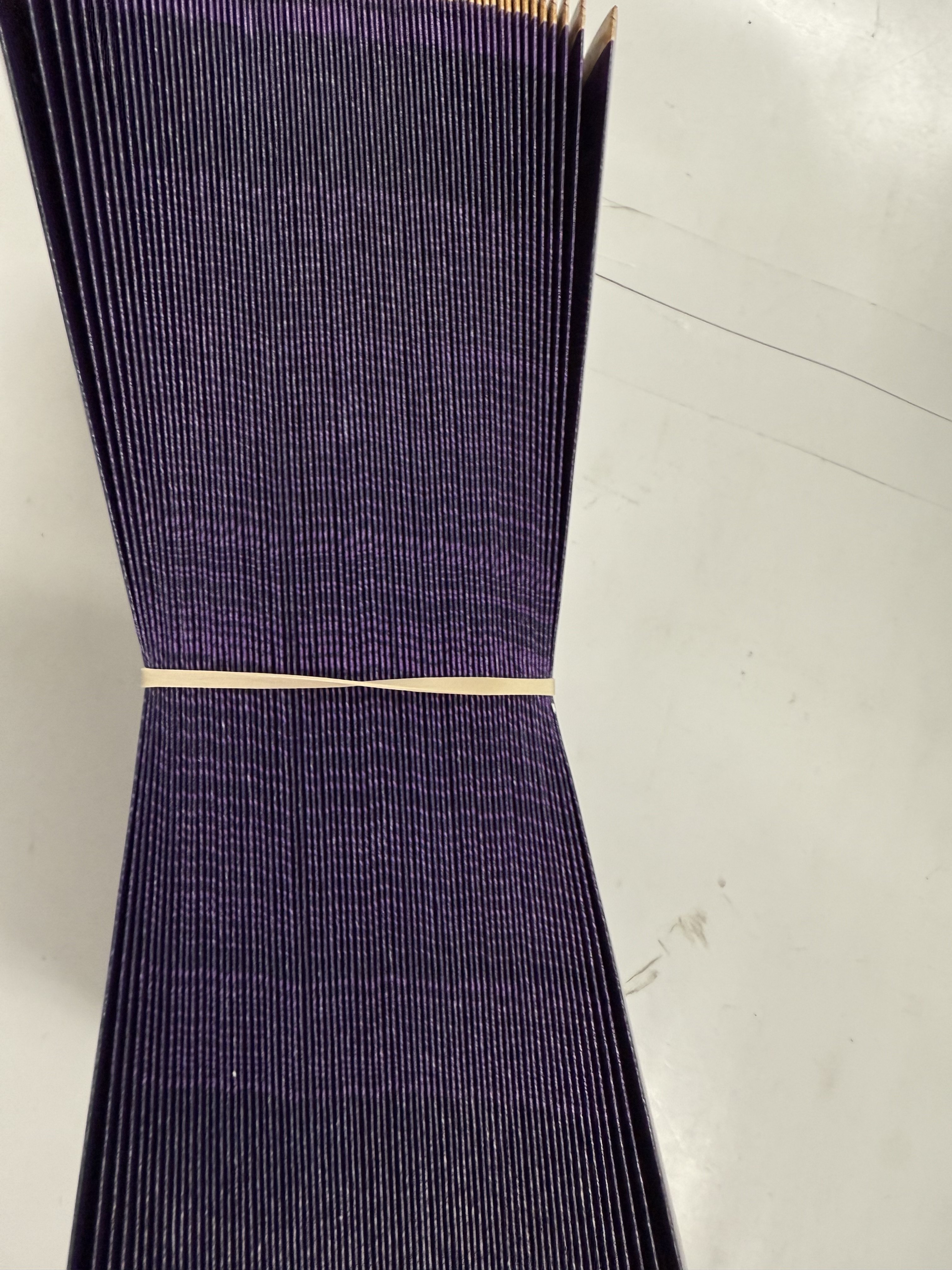

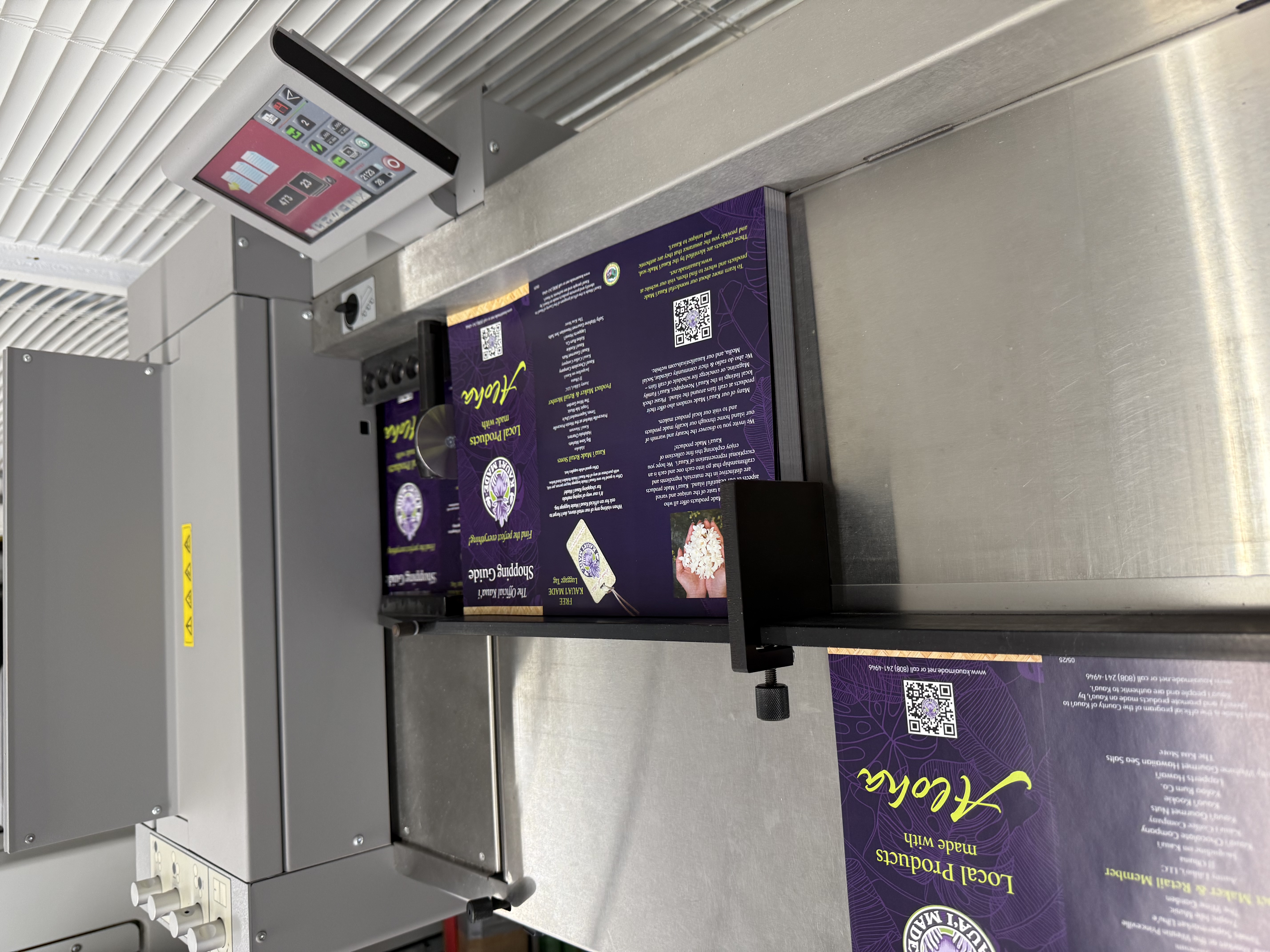

We use Morgana Digifold Pro that creases and fold in one machine. Floor space is minimal. Never had any problems with it for the last 4 years. We are currently running a digital (Ricoh 7210) 6000 qty trifold job on 100 gloss text that has the maximum 300% ink coverage and the Morgana folds without any cracks and consistency is spot on. We are also using the optional thin stock creasing matrix. 20-28# uncoated paper we run on a stahl. Never tried it on the Digifold after hearing it doesn’t work well with light stocks. If I needed another digital folder, it would definitely be a Morgana.
