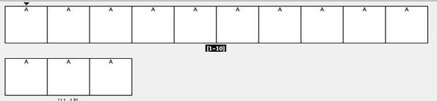

I've just stumbled upon something in ID that may be intentional in the code, but I can't seem to find anything that documents it.
I was hoping to put 13, 270mmW x 235mmH pages side by side. I am able to put 10 together but that appears to be ID's limit. See the attached screen-grab. When I try to move page 11 to the right of page 10 nothing happens.
I know I can make a single page doc that is 3510mmW (270x13) and just add 13 gutters, but I was trying to keep them as separate pages.

Well then one suggestion is to make two 5 page spreads and output a pdf of each. Then place these into a new ID page that is 10 pages wide.

I don't really understand why you want/need to set it up in 13 side-by-side pages, but you can do it in Illustrator.
