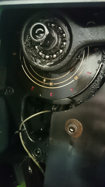

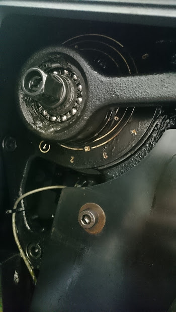

Thank you for the attached PDF. My Sm 52 has 6 white and 6 red numbers with the difference that the white number 1 inside the circle.
I think you can see in the pictures I've attached.
According to the PDF that you attach to the position number 1 is at least equal following the application of ink on the sheet, and the numbers 2,3,4 most balanced application of ink.
