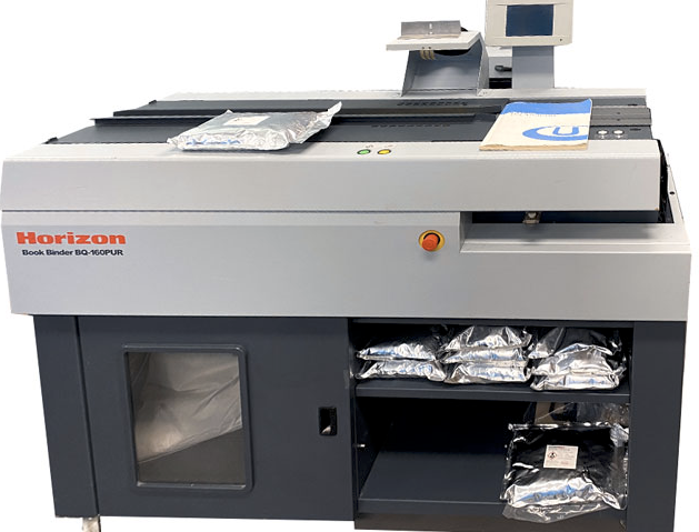

Also there seems to be two major configuration/shapes A lot of the very budgets ones are a box like shape. (photo one) the more expensive ones are a coffin shape. photo 2. Differences? I'm guessing the box ones (photo 1) are very manual.

You need the 'coffin-like' binder version, as the other kind can't reliably position the content pages into the spine area of the cover. Also the scraping of the spine is a joke; the box shape machines are for general office use, nothing more.
