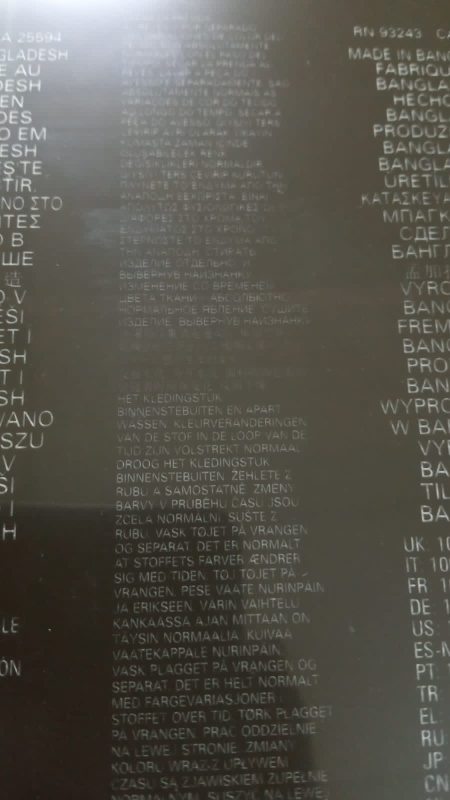

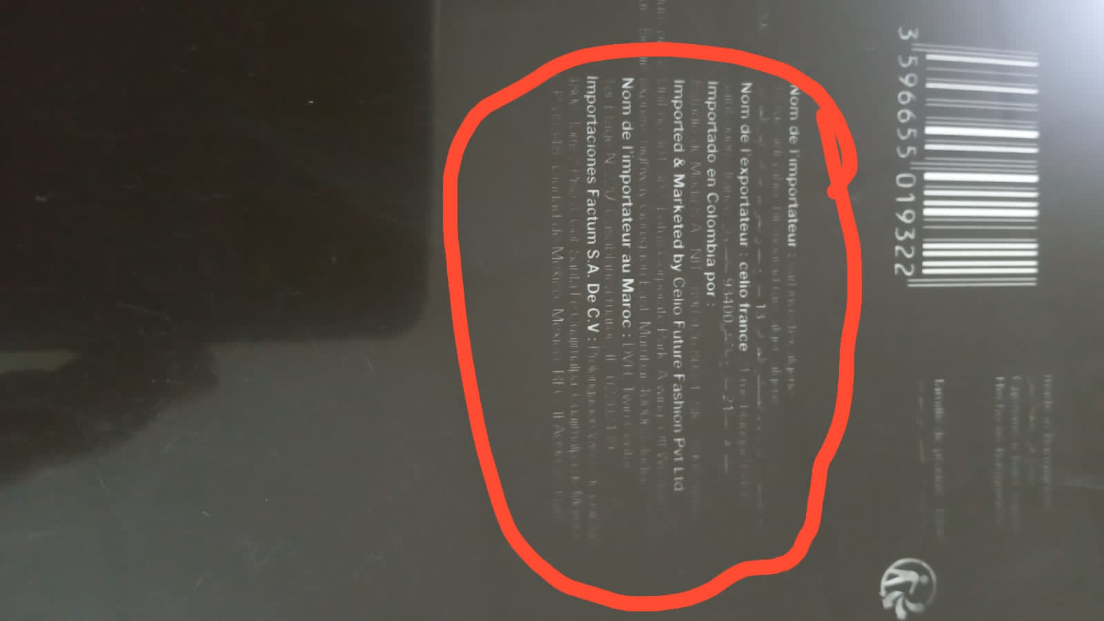

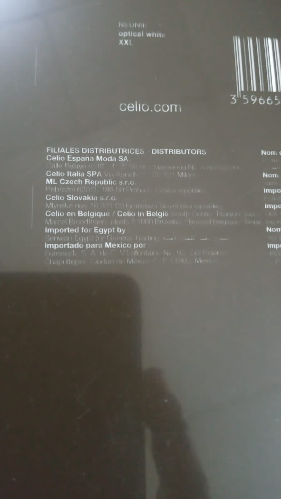

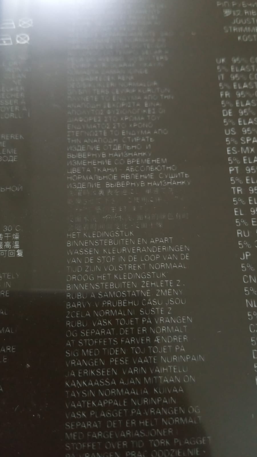

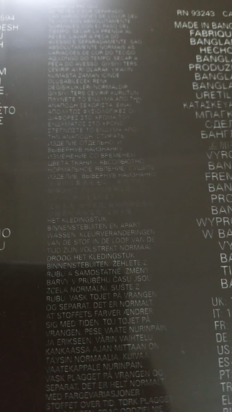

natiqur Active member Oct 2, 2021 #1 In a Katana FT-R5055 Imagesetter image comes as like the attached picture. Some fonts are clear and some small fonts are broken. Please suggest. Attachments IMG-20211002-WA0000.jpg 47.4 KB · Views: 463 IMG-20211002-WA0001.jpg 59.7 KB · Views: 443 IMG-20211002-WA0002.jpg 88.1 KB · Views: 439 IMG-20211002-WA0003.jpg 55.6 KB · Views: 445 IMG-20211002-WA0004.jpg 37.8 KB · Views: 480
R Repro_Pro Well-known member Oct 4, 2021 #3 Are these images on film? What do you see under a powerful magnifier? Out of focus or plain "fog"?
J Joe Well-known member Oct 4, 2021 #4 Looks like the text is an image, 300 dpi or lower, instead of vector that should output at the highest resolution of the output device.
natiqur Active member Oct 10, 2021 #5 Dear Sir, This problem is solved after replacing the SRAM Board. Thanks.
