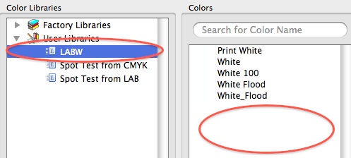

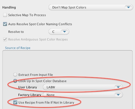

kseldridge1, on your InDesign vs. Acrobat colour conversion issues: As stated earlier in the thread, I have not been able to reproduce your results... So I will leave that to Leonardr, who works for Adobe.
As for your workflow issue, all I can do is show you how I would handle things using Kodak Proofing Software - perhaps this will give you an idea to look for a similar method in your RIP.
KPS spot colour options allow the RIP to look in a look up table first, if the colour is not specified correctly by name then the "alternate colour values" in the source file will be used instead.
The look up table would then only have white ink in it, so if the source file had another spot that was not the named white ink, the build in the file would then be used.
Two images attached.
All the best,

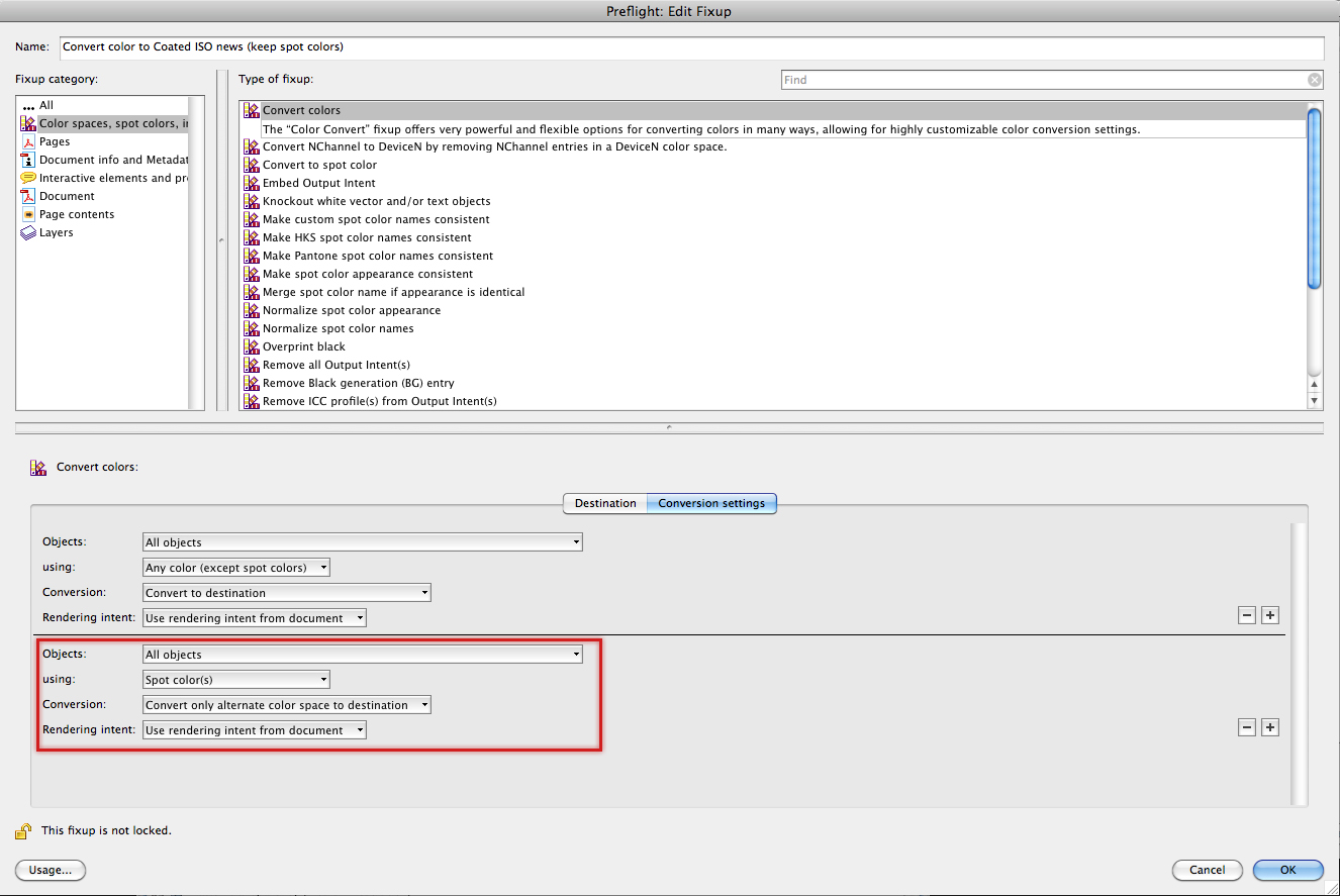

kseldridge1,
I think I found what you're looking for. InDesign is changing the alternate colors of the spots. You can do this in Acrobat in a Preflight.
Take a look at the attached screen grab.
It works! Thank you for taking time to address this. Exactly what I am looking for. I was making the second fixup for spots to 'convert to destination'. I should have dug a little deeper. Adobe is golden, It was simply operator error.
