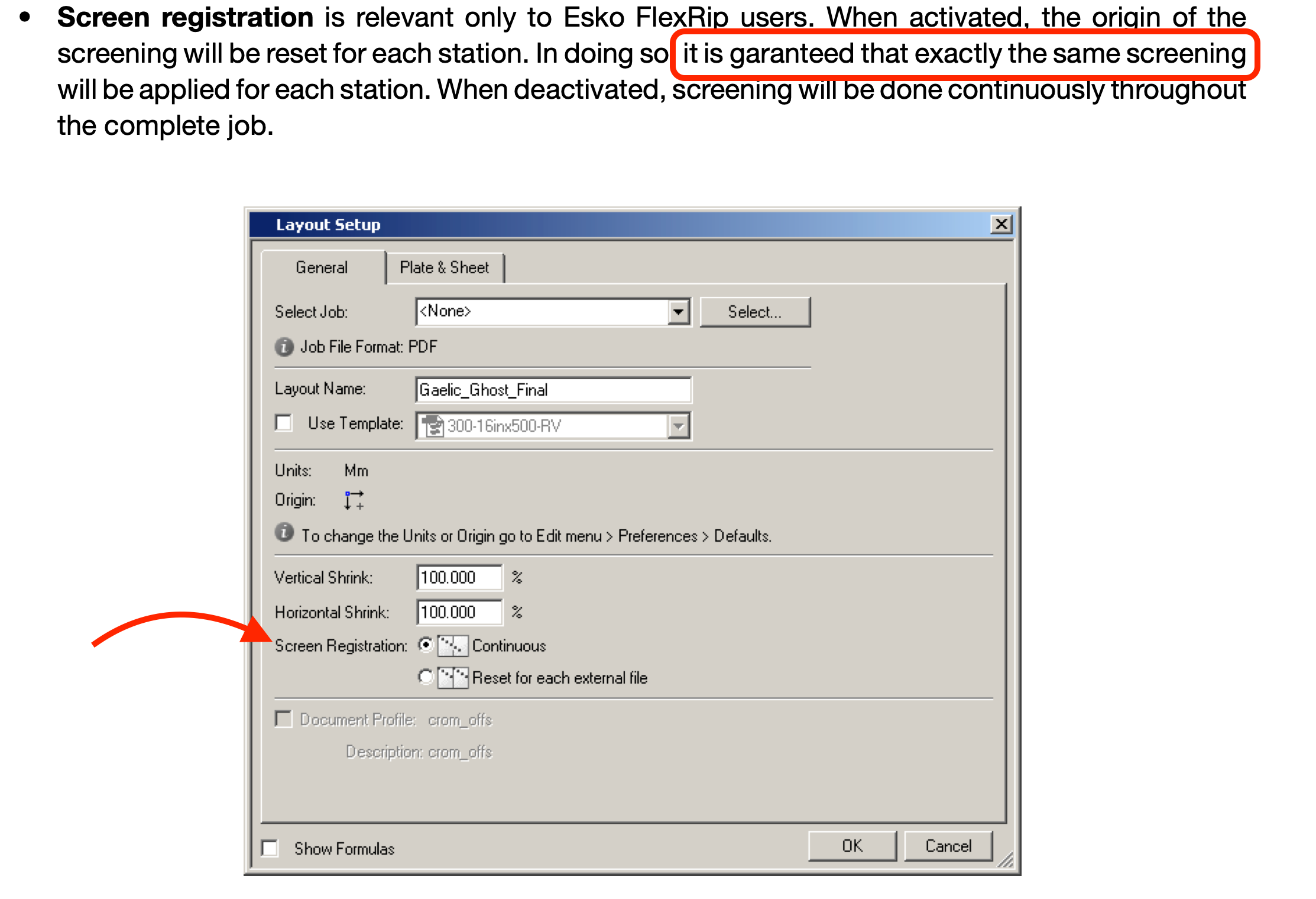

Esko says it is currently not available in IE that we must use FlexRip.

@SteveSuffRIT What are you using to step your file?
There are two options inside of Plato (and I think somewhere in Automation Engine if you are using AE to step). Make sure you check the option 'Reset for each external file' if you want exact screening on each repeat.

Till, We are using Esko Imaging Engine. According to ESKO R&D, the Screen Registration function is slated for the Nov 2020 release and currently works only on the older FlexRip. I still don't see this as a major contributor.
