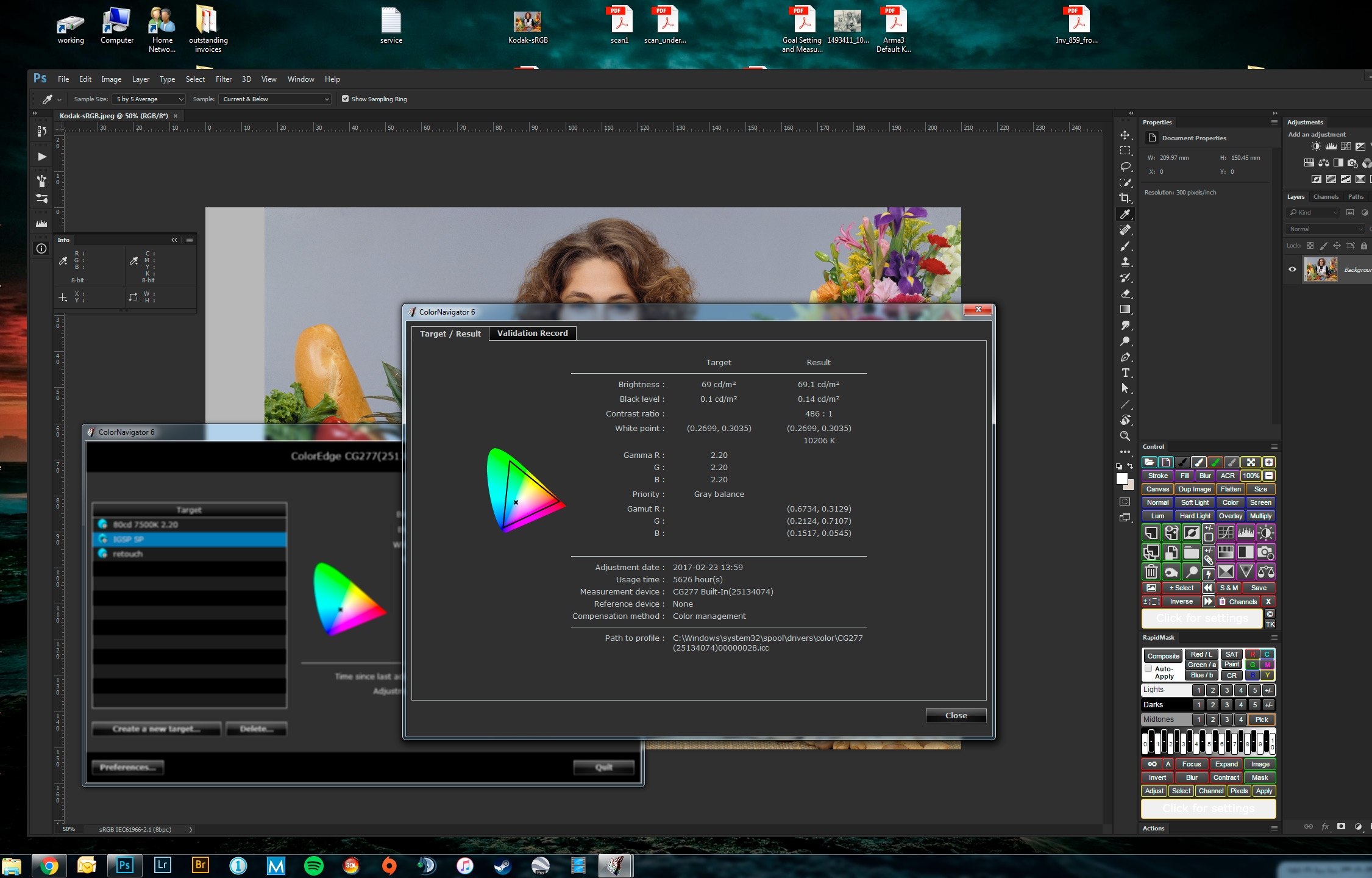

Hoping to get some advise about something from you fine folk. Learning colour management and trying to get my workflow in good order, I am experiencing something which I think is quite wrong, going from everything I have learnt so far.
I am using an Eizo CG277, on board calibration device, calibrated with Color Navigator. Using quite generic parameters on 80 cm2 - minmum black point - gamut 2.2 - white point of 6500, everything on screen looks great, these are the setting I use to edit my images as a photographer.
So when I send to the printer, an Epson 9800 using Ilford Galerie Smooth Pearl, I am getting a very different result back to what I would expect, also using correct custom icc profiles from a reputable dealer, and softproofing correctly. My prints are coming back extremely cool.
To get a side by side, screen to print match I need adjust my screen white point to over 10000K???
I have tried everything I can think of, do you think this is normal or should I be looking at something in particular?
To me it just seems strange to need to put my white point this high, I mean the screen to print is really good at a white point of 10000 but i know its not right, should I leave it and use it like that or is there a problem somewhere.
Any help getting me through, or even helping me understand where it is going wrong would be so helpfull. Thanks..
Should also add I have good ink levels, clear nozzels ect..
I have attached an image with my calibration.

I didn't state it directly but I do the printing myself, using my own 9800. I am very careful right from the raw file, I edit in 16 bit using the adobe RGB working space which is where it remains, embedded in the image. When I send it to the 9800 I am also as equally careful in selecting the right printer profiles usually using perceptual , the profiles of which are custom for the paper on the same printer, not this exact printer but another 9800. I have also tried the canned profiles from the paper manufacturer with the same result.
The low screen brightness serves the purpose of getting my contrast ratio down to meet the papers dynamic range. For example a 60cdm2 white / a 0.2 black = 300:1. If I were to use a setting of 120cdm2 / 0.2 black my contast ratio would be 600:1 ect ect. You can see from the attached image above my screens contrast ratio using those parameters is 460:1, high but low enough for the paper type. Using the monitors hardware calibration to get my screen brightness down (white point, not luminance) to match the dynamic range of the paper is by far a better option than using the simulate paper option in softproofing.
I should also note I use a different setting for my general editing, only switching to this calibration to softproof. Also I do in fact work in a very dark room with low ambient light.
From where I am looking I see all my ducks in a row (far be it from to say), still I cant see why I return such a different result. I am contemplating perhaps its my screen but it seems unlikely.
