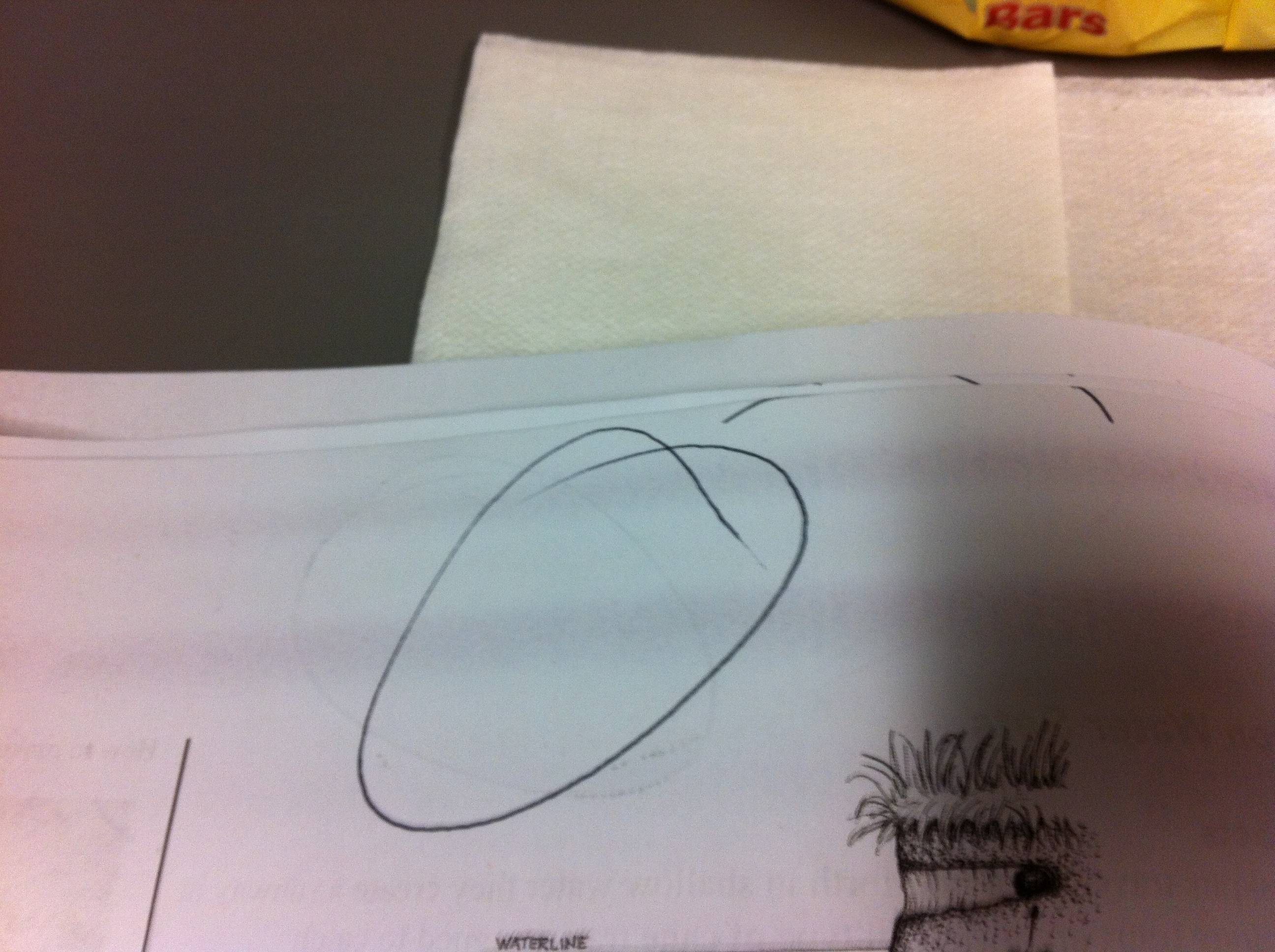

We are having a problem with our Web printing. We get striping on the lead edge. I'm in prepress and trying to help.
Pressmen are telling me they can't get rid of it. One pressman thinks it's from the rollers bouncing when it hits the plate gap. Another thinks it's from cheap ink.
Has anyone seen something like this or ,maybe, can offer any suggestions? photo2.JPG

It is on all units. It has been around for awhile, sometimes it's worse than others. It's a Goss Community.

They are not blaming pre-press. I am trying to take the initiative and try to find an answer to their problem because they are just shrugging their shoulders and saying "we don't know". Not good enough for me.
It's definitely a press issue. They are telling me rollers, blankets, fountain solution are in spec. It's always on the lead edge, if that helps with diagnosing.
Check the packing of the plates and blankets, if they are packed to different overall diameters, this type of streaking can be one of the results. Do the pressmen complain of tail cracking as well?
Thanks, Dan.
No tail cracking. The plate cylinders are made for the thickness of plate we're using (no packing) and the blanket packing, rollers, and blankets are all new and to spec, I'm told.
What are the specs the plates and blankets are packed too?
From our GM: "The plate cylinders were manufactured to run a .008 thick plate with no packing. The blanket cylinders require .085” total blanket plus packing. All units"

Hello jsnKiefer,
What you are seeing are - Cyiinder Gear Marks - these marks are related to the Cyl Gears Teeth Pitch Circles
To eliminate this problem - the Blanket/Plate Cylinders Pressures need to be Reset by a Qualified Press Engineer !

From our GM: Plate is .008” undercut. Blankets undercut .081”. Yes we are running .008” plates. Blankets are packed to .084” total blanket plus packing.
