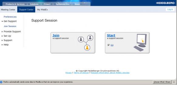

So what type of plated are they using? And yes he is right Heidelberg needs to do this And they can remote in or login from the internet. They would do this with us.
Unfortunately there are only two suprasetters in our city and i think same situation in rest of the country, so there are no local engineers.
this is all you need to do just call them and set it up.

Suprasetter arrives the customer without limitations for plate setup. Focus, laser power and drum speed adjustments are very easy. But it is also possible to arrange a password for plate setup by Heidelberg local service or the customer. Without password, related parameters can't be changed for plate setup.
In ctp user interface go to input and select one of material that you defiend and double klick and next next until you reach the laser power tabs and then you can change laser power
