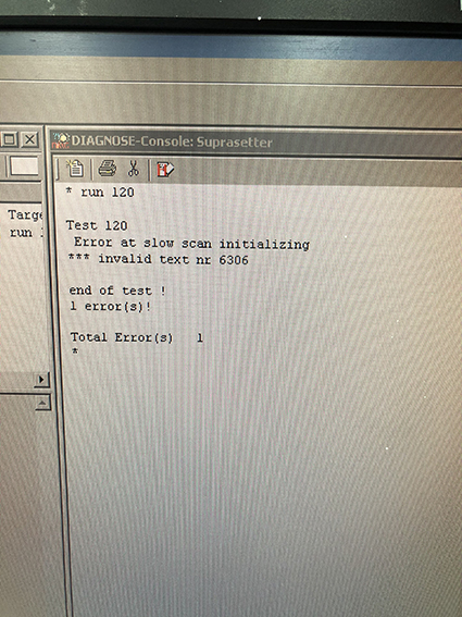

Hi... any help with this problem...
I try to solve it, but i confuse about the error, the edge sensor is that sense the widht plate when you introduce the plate to the CTP...
But this error appears when i turn on the CTP... and never goes online becaouse this.
I enter in diagnose mode, to see if can check from here, and when i try to initialize the slow scan to move the carriege to the right, this never initialize, i get again the error 6306.
I dont know if the sensor is damage or the motor sensor, and this couses that the slow scan motor doesnt work
any idea??

I looked up the error list said it's a defective edge detector. Try disabling the edge detector in the parameter to isolate the fault if it's the edge detector or slow scan motor.
Thank for you time.... i try to find the PID for disable the edge detector, but never find it....you have it? I login in the container for service and developer.
