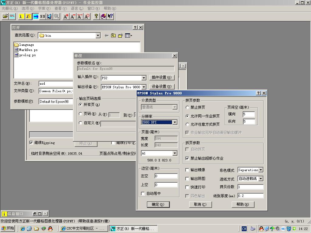

I'll send a video from China Inkjet System Operation - Nanjing Jiang Asia Digital Technology
How can not upload video??
