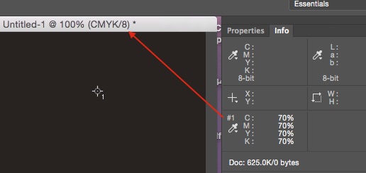

It reads 70% for me in CC 2015.

Thanks, everyone. This has been an interesting one for sure. Joe, can you confirm that your document was 16-bit?
OK if I just 'Fill' the image with 70% of all colors it shows 70%.
If I fill it with the Paint Bucket tool it reads 69%.
I just got the same thing in CC 2015 (16.1.1), very strange.
