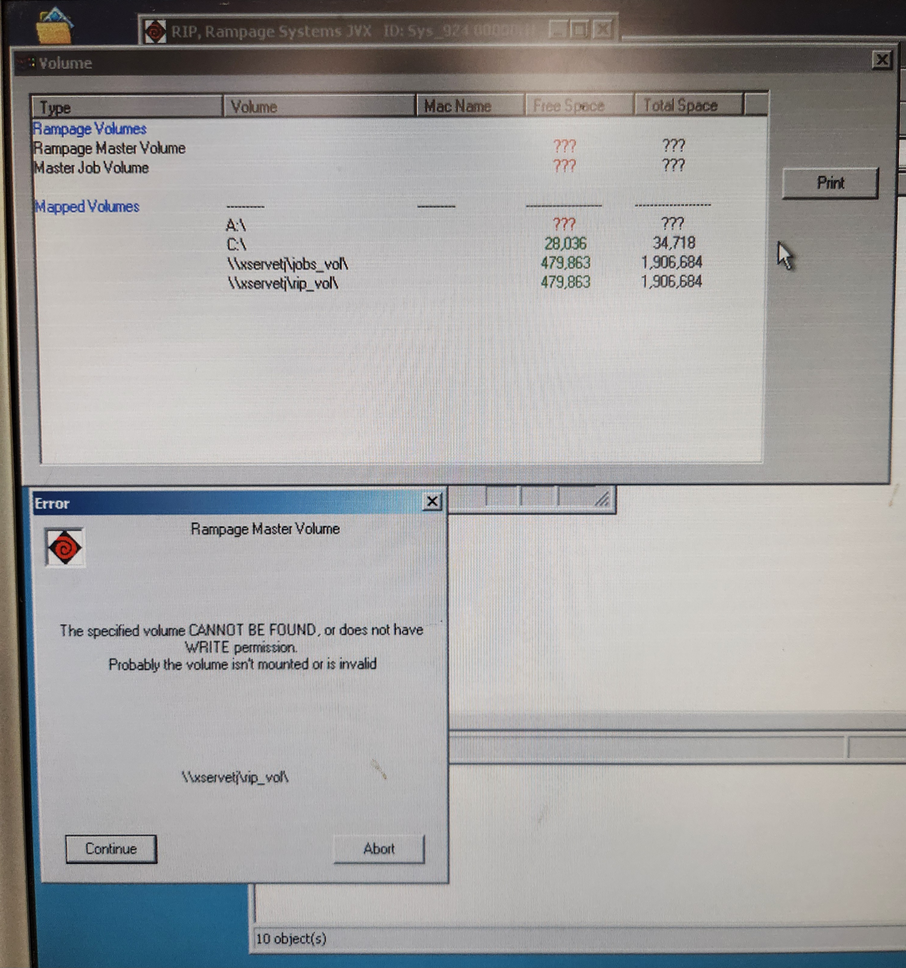

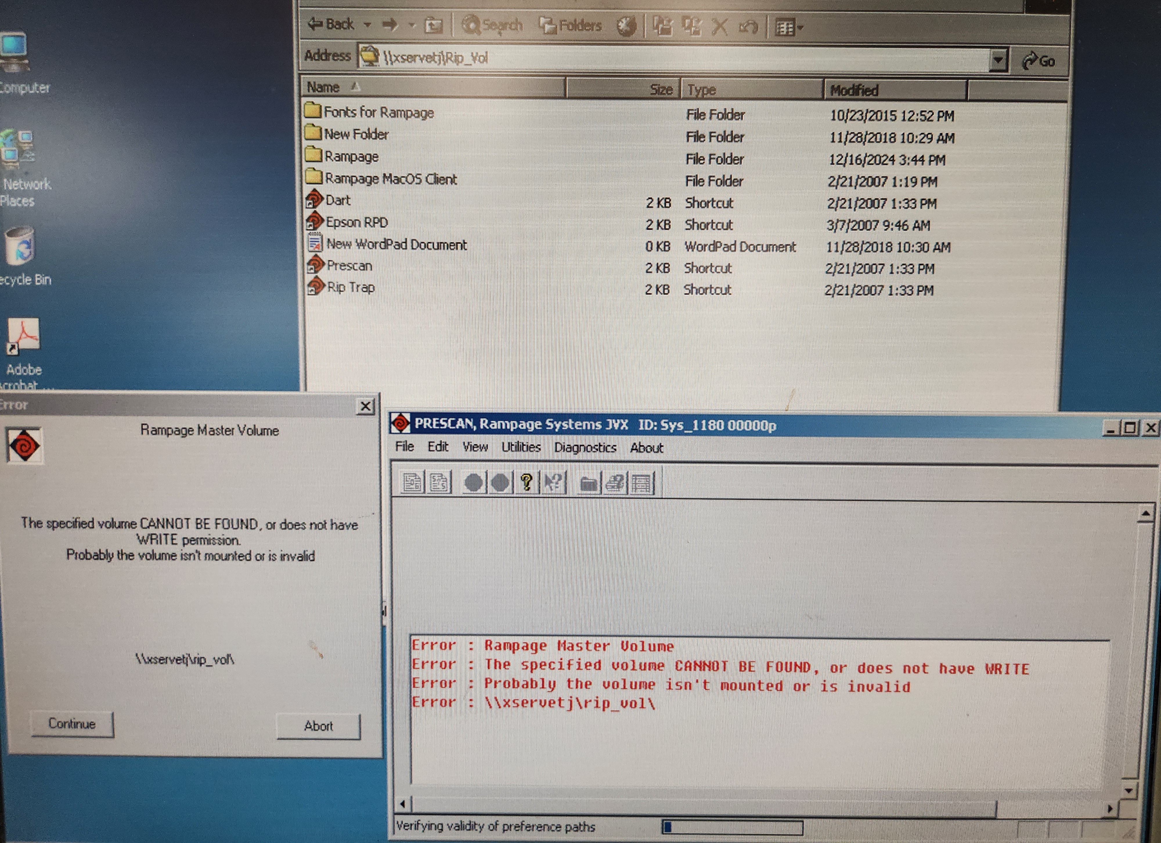

I brought the PC back today and am running into problems with the Rampage application accessing the file shares for the Rip folder and Jobs folder. With the rsi and Rampae folders copied from the old drive, the program is pointing to the correct file shares, but says that volume can't be found. I can map the drive in file explorer and can create and edit files so it seems to be something specific to the application. Any ideas on why I might get this message or what can be done to troubleshoot.
