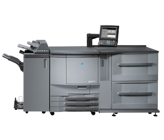

Why in a haven, would you look at any of those? I, honestly, may not be uptodate with Sharp and Toshiba but some years ago I worked as tech for a Sharp / Toshiba dealer. B/W Toshibas were OK but colors were terrible Sarps were the worst machines there is (some may dispute and say that there are worse machines but still, even B/W boxes were terrible) At some point Sharp was remarketing 60 /50 ppm B/W Toshiba Boxes and later Ricohs because they could not make descent unit of their own. Anyway both of these manufacturers hold a fraction of the color machines market and simply office machines. I mean you want some reliability and longevity to come with your list of requirements right? KM Bizhub C6501 is an excellent machine, overkill or not - it is far more superior to anything that Sharp or Toshiba has to offer. Please don't kid yourself thinking that you will get out of any Sharp/Toshiba what you have from C6501 but for less money - It will be POS unit that will cost obviously less but then you have to cross out 2/3 of demand list.
By the way, I understand that this is not a "sell me something" post but let me offer you something: I have a KM Bizhub C65hc with only 229k on the meter, (this is pretty much a C6501P with High Chroma Tones) Saddle stitch finisher, Large capacity tray, EFi Fiery Pro 80 Rip $16,000 - I can set-up $1 buyout lease if you want for 36/39/42 month
Let me know if this sparks your interest in any case - you don't have to buy my KM obviously but Sharp or Toshiba isn't a wise choice for sure besides staying with the unit you are familiar with, knowing how to run it, what to expect is a good idea.
The picture attached is exactly package I offer.
Here the link for the brochure:
http://product.konicaminolta.ru/files/Products/bizhub PRO C65hc/Brochure_bizhub_PRO_C65hc_en.pdf
