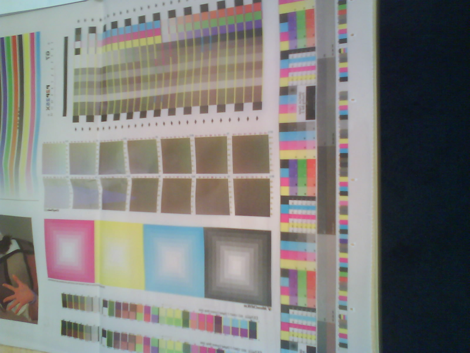

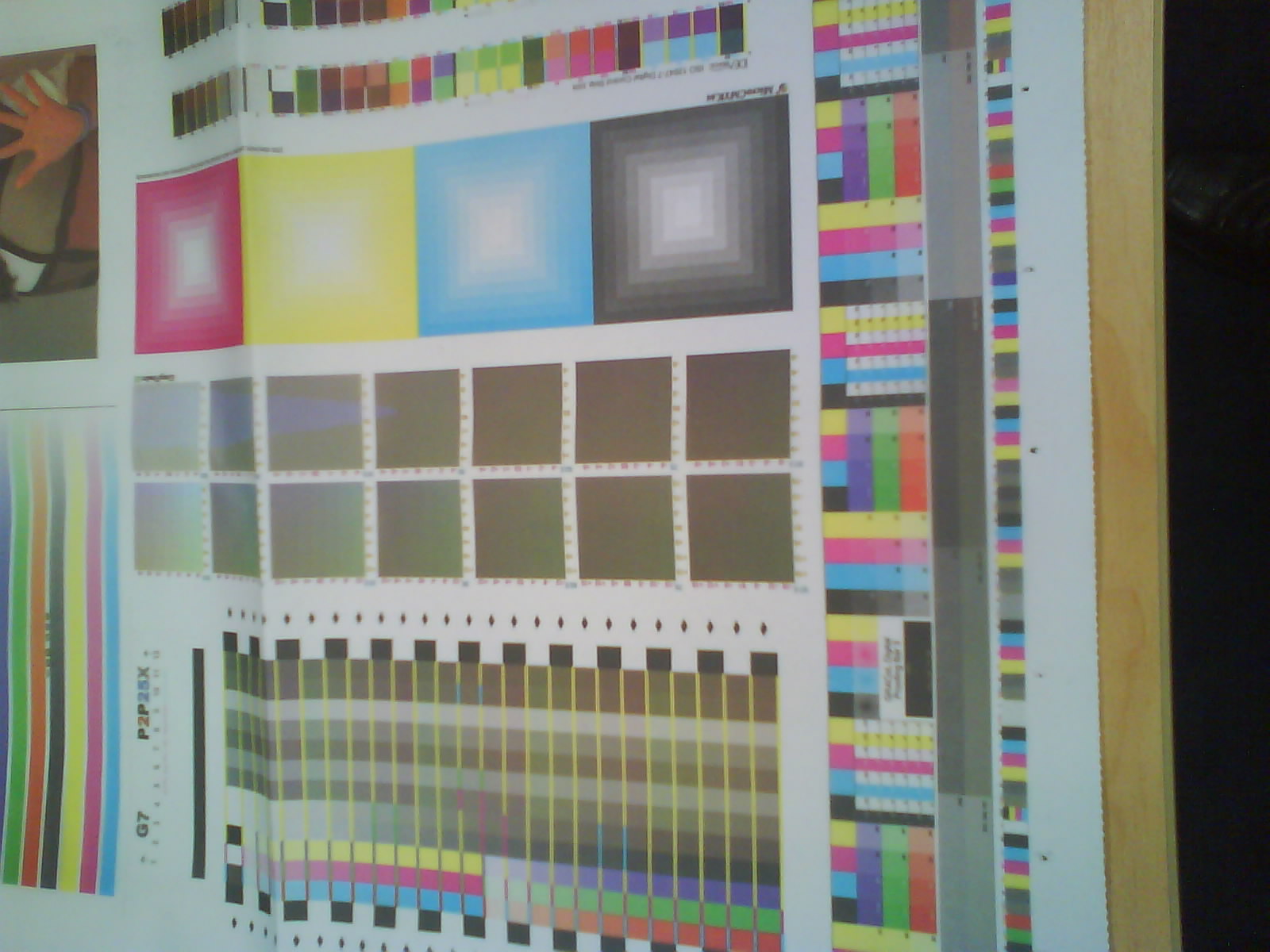

We are running a test this week and i will report on how it went, as a pepsi challenge the press is a Goss HT70 (newspaper) press which is coldset i.e. no drying
the press itself will be cleaned and a stripe test will confirm ink train tolerances, i have set the TIC at 170% and will run G7 targets

We ran the press test, very successfully i may add, no issues realy other than loosening up the secont rollers in the folder, ran A Gracol G7 test page concurrently with TVI of 240%.
due to the lack of absorption of water registration to the image on newsprint may go out as the paper stock will fan out
i think the key was the press itself, as mentioned before by a member no oven meant the paper didnt go brittle
