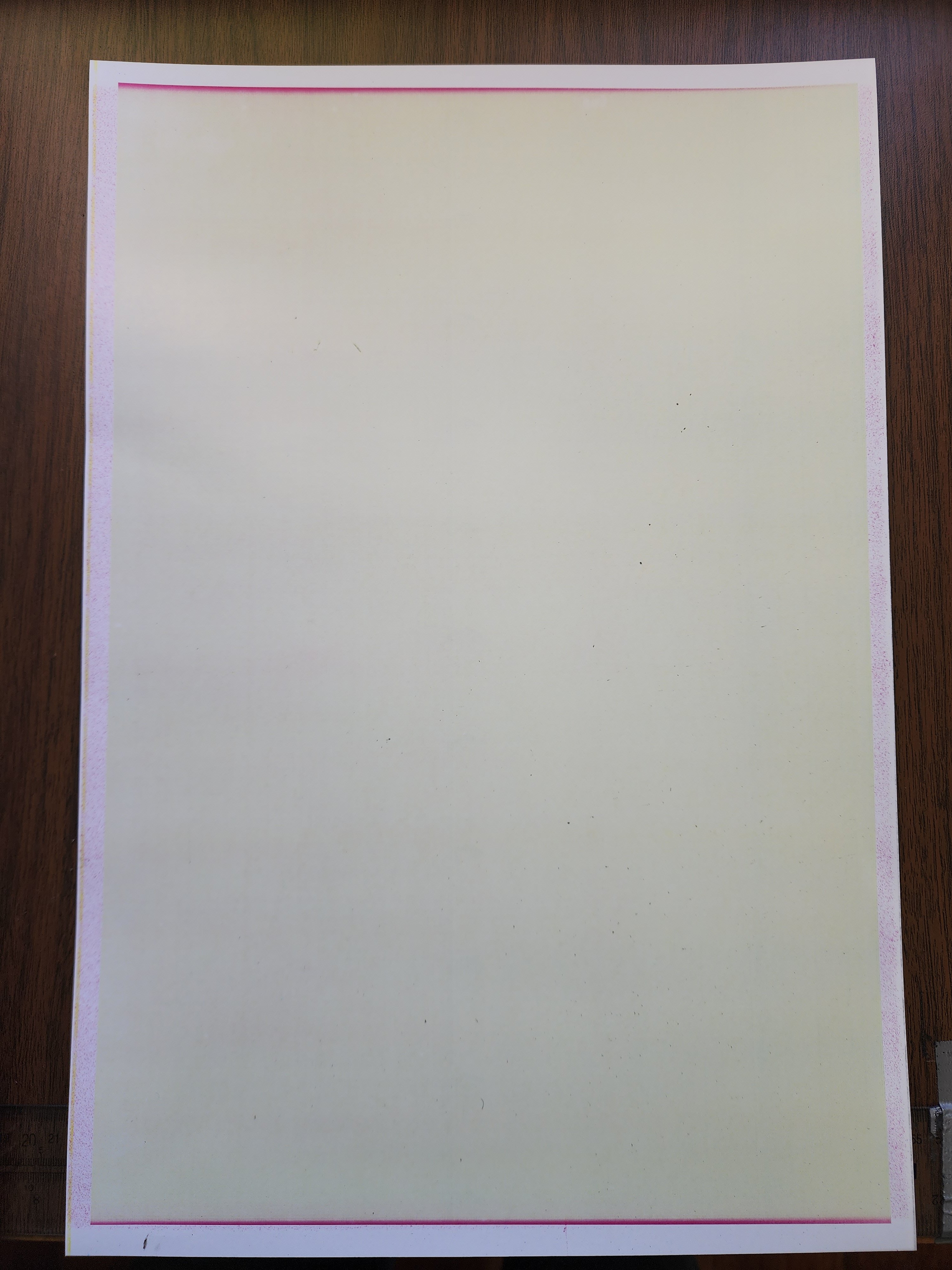

E ewisham Member Mar 17, 2026 #1 Good afternoon, I am having an issue with magenta not printing. I just changed the magenta developer. I included the a copy of the output page. Thanks for any assistance! Attachments 20260317_162932.jpg 943.6 KB · Views: 169
EdwardB Well-known member Mar 17, 2026 #2 did you also change the drum? did you remove the plastic clip that is attached to the paper wrapper as well?
M MRAUSSIE Member Mar 17, 2026 #3 Very common, its a Developer Bias HVPS board that will need to be replaced in the back of the printer.
E ewisham Member Mar 17, 2026 #5 MRAUSSIE, Is there one for each color? All of the other colors print correctly.
