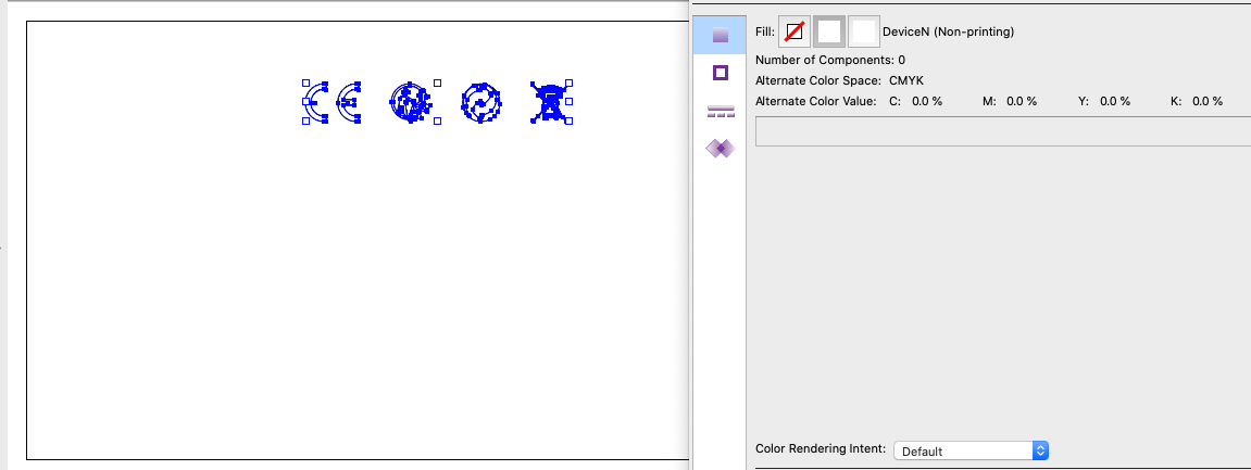

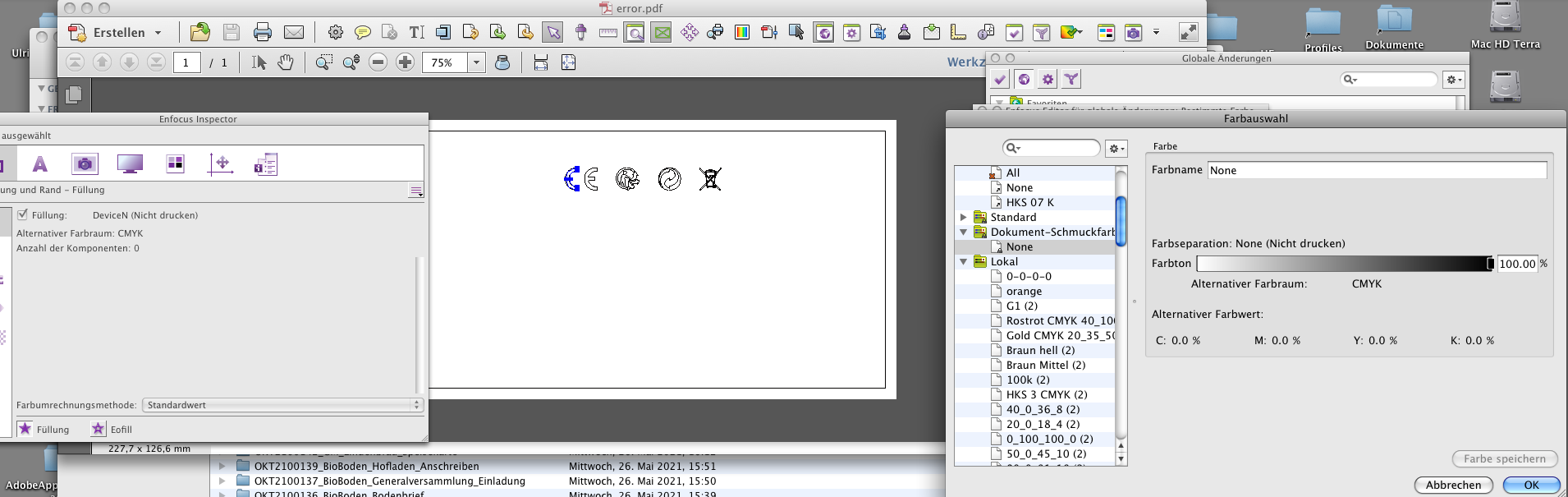

the in Acrobat non visible elements mode is DeviceN, but the name of the DeviceN-color is "None" (in German: "Nicht drucken")
I am not 100% for sure, but if that alone does not force a disregard by previewing a RIP, i guess, that (the name "None") causes a mapping into the mode separation color (e.g. "All" is mode Separation color also...).
But "None" should expressly declared not to be reckognized by any RIP or professionel Preview interpreter like AcrobatPro and should expressivly not to be printed...
Remember e.g. a DeviceN-Cyan-object (mode DeviceN) in in a cmyk-file: you will not get a 5th separation/plate, it will be moved/mapped into the CMYK-mode/Separation-channel by RIPping...
But here it is "None"
May be someone had just called his own created spotcolor with that name or had klicked the None-filling in the color-palette, thinking that causes white/just not a filling or had changed it after export in PitStop or something else...

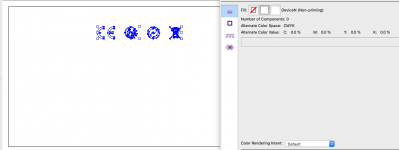

abc
What he said...
For the future you can preflight for a spot color called 'None' and although it's not in the output preview it will be flagged as an error.
It's mixed as Zero% CMYK
At least in PitStop, but I guess in others as well.

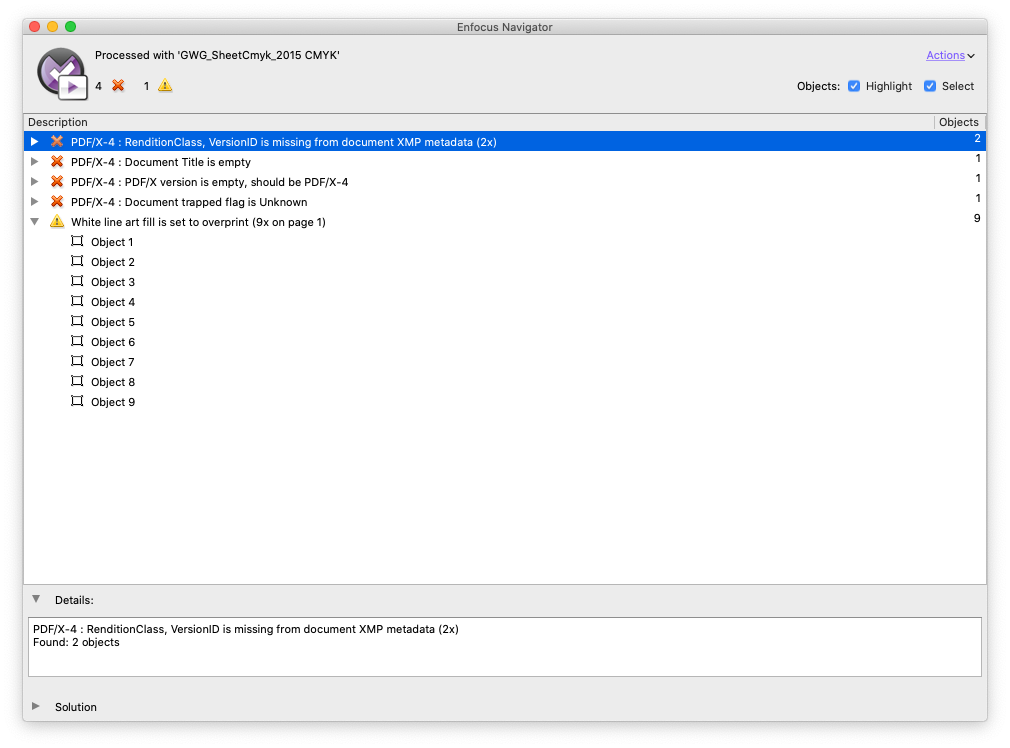

abc
BTW also just checked. The Ghent Workgroup preflight profiles (at least the 2015 ones) will flag this as an warning for overprinting white lineart.

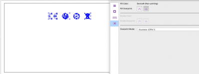

Joe

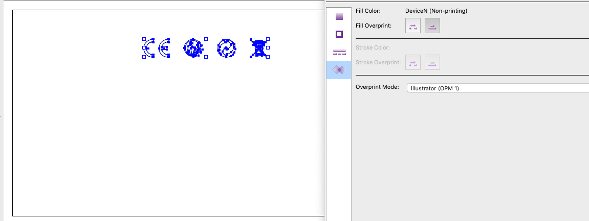

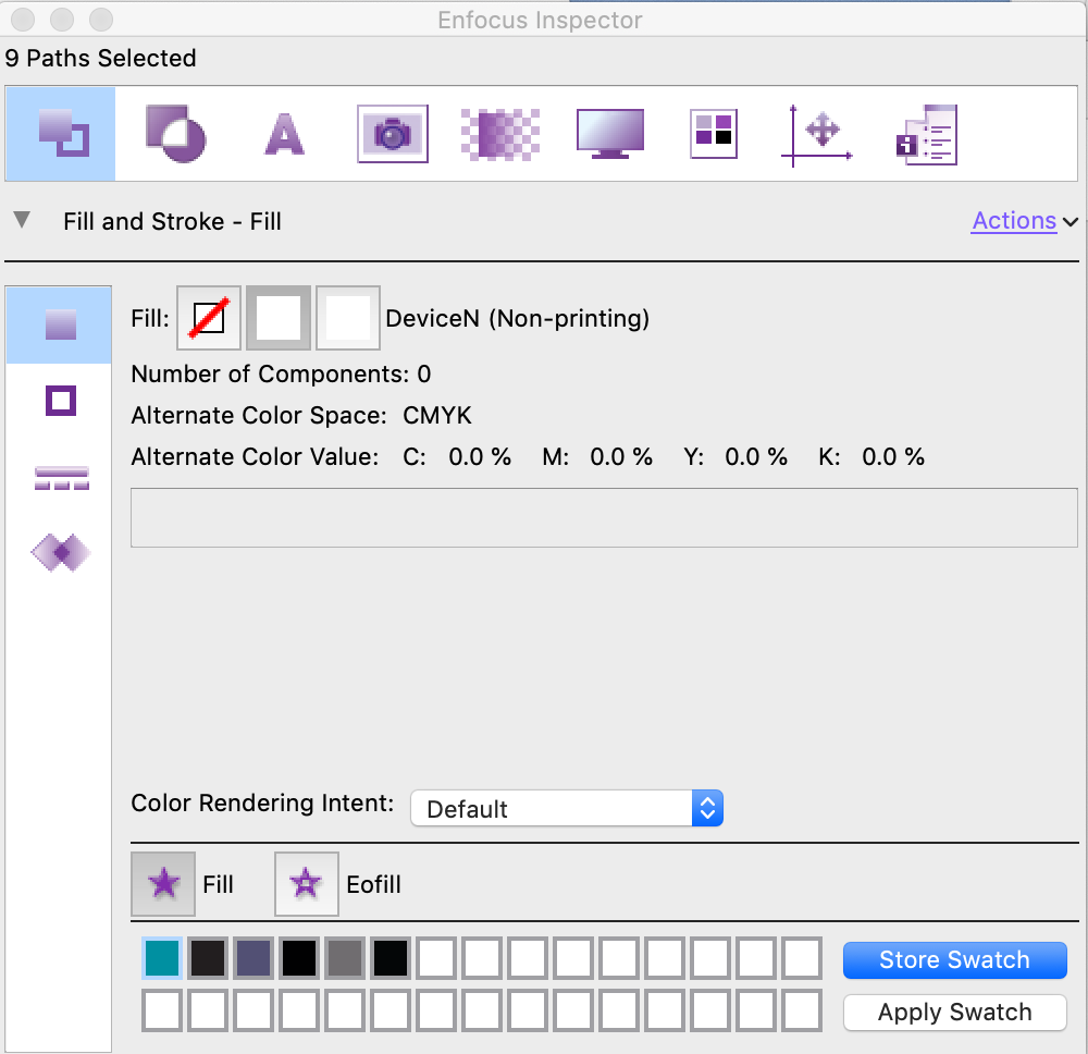

Pitstop shows it as DeviceN (Non-printing). Converting to CMYK makes it knockout white. OS X Preview will never display PDF's files transparency correctly. And as others have said pre-flight will flag it and correct it if you want to.

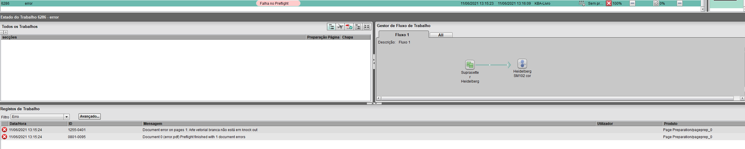

XMF preflight gives out an error that roughly translates to "White Vectors are not in knock out".

Sorry, but it's not Acrobat Preflight that gives the error. It's Fujifilm's XMF which has Pitstop integrated and outputs the error on a PDF.
If you take a look at this screenshot, the error is reported by XMF and then it generates a PDF with the error report.

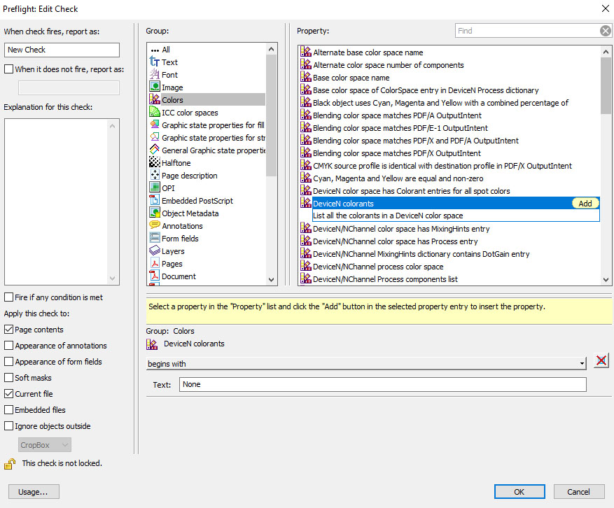

Puch

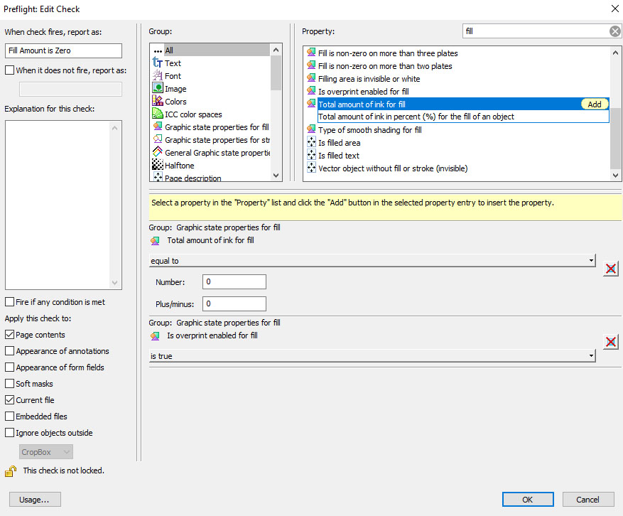

Please see attachments for an Acrobat solution. Of course these profiles must be tested to avoid false positives.
