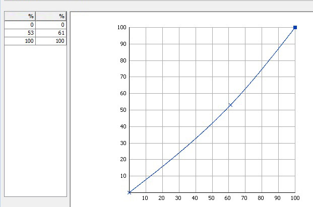

Thanks Gordon, but my problem is that I can't print the whole range (10-90%) of patches and then search for the one whose measurement is the same as my customer's patch (as I would normally do).
I can only print the same 3 patches.
So here I am getting lost...
If his 40% patch measures 53% and mine measures 61% ... I don't know how to use this information to create the curve, so that when I next print out my 40% patch also measures 53%.
With one data point:
It's basically a guessing game.
The "At the 40% adjust your curve to be -8%" Steve offered is unlikely to give you what you want but might make you feel that at least you're trying something.
You could also try with generic curves - his in RED and yours in BLUE (use your actual curve if you have it) (green line shows method as per the link to my blog).:
So, you would set your 40% to 31%. You can use this method if you have the data from your client for the 25% and 8% as well. A more accurate guess (because of the unknown actual curve) than Steve's but still a guess.
