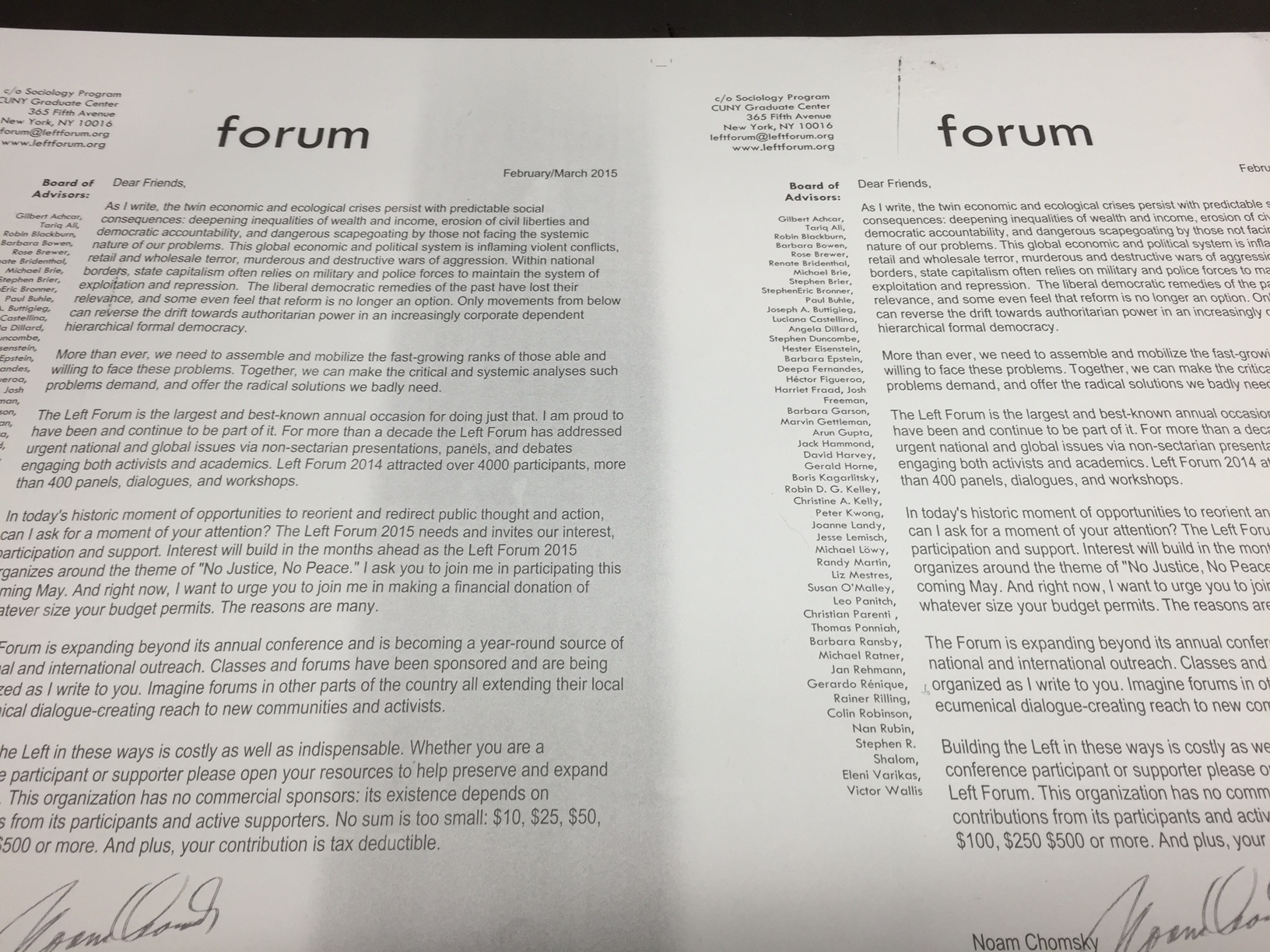

Hey everyone,
The monster of a toning issue is back. Or actually it never left. I've got a Ryobi 3302 with the Crestline Altra system on it. Both heads have all new rollers except for the hard rollers (every rubber roller is brand new). I'm using Total Chrome Free fountain solution at about half an ounce to a 28oz bottle, and poly plates. The first head runs fairly well, but the second head gives me this wide band of toning from the OPS to the NOPS. I've attached a picture to this message so you can see what I mean.
I've checked and re-checked the roller stripes countless times, every form roller plus all the Crestline adjustments. The stripes are set to spec, and are the same as they are on the first unit, which prints well. Same plates, same fountain solution ratio, same everything, and yet there must be some variable that's screwing me up. What could it be? I don't recall when the problem started - it's definitely been since I put new rollers in, but when I switched ink rollers, I actually did that head first and then did the first head, which, again, prints well. Not to harp on that, but I just want to drive home the point that I've done all the obvious things and still can't beat this. I'm seriously at a loss.
Before I call in the technician, I figured I'd make one more last ditch effort to figure this out. Can anyone think of anything?

I'm out of the shop today but can give that a shot tomorrow, and will definitely share a picture. Yeah, unit 2 is the issue. The first unit used to print badly but once I got new rollers in it and got them dialed in, it seemed to perform a lot better.

IS the "Scum Mark/ Catch-up" --- Always in the same area ?? - halfway around the Plate circumference ????

I will wait to see the dry solid he pulls on unit 2. Plus a video of the machine running may help determine the condition of the press.
The man stated " the first head runs FAIRLY well. FAIRLY well is "I'm not happy with it." The second unit not so good. Trying to fix a press problem without actually being there is pretty hard to do. I know PH can trash ink if the solution is too hot. I also know that if it's too weak it won't print. It'll scum and wash out. I agreed that the conductivity needed to be at least 600, not that bit about plastic and PH. I simply made some suggestions that could be considered. I'm not there, so I do not know for sure. I've ran and worked on both the Ryobi and the AB Dick 9995A for several years. Not a fan of either or the water system mentioned. They're just too touchy for me. I'd rather run a Roland, or a Meihle any day. Have a great day. R.

I know you've checked the roller pressures but it still sure looks like that. Sometimes pressures can look good when you have too much pressure. Have you tried backing off some. Just a thought. An easy test for water pressure is pulling a strip of film to feel that the tension is even. If you can't pull the film between roller & plate at all, you have too much pressure.
Guys! Somehow I totally missed all these replies. My apologies. Thanks for all the input. I probably missed these because after going through my pressures again, some things were off and I ended up getting the head to work. I also found a ton of dried ink and crap that was preventing my ink ductor roller from ducting properly, so the Crestline wasn't getting enough ink. Once I figured that out, it was almost too easy. But now it's got the toning disease again! I think that when the weather got warmer (we work in a commercial space that's basically a glorified garage, so not in the least bit temperature controlled), it threw everything off and I'm having trouble getting back to a good place.
I've inked up with yellow to check the pressures numerous times but it's just not giving me clean prints. It's not as drastic as before, where there was a wide band in the center of the sheet. Now it's just sort of general toning all over. I mean the whole blanket is getting inked, essentially, because of all the toning. Ink forms to plate is 3mm. Water form to plate is 4mm. I went through all the Crestline adjustments and got them all to spec. The ductor roller is fine. The ink train cleans up pretty fast and thorough, although the Crestline pan roller seems to have trouble on the ends. Maybe the issue is somewhere in the Crestlines, they're so damn finicky. I spent lots of time today trying to dial it in. I think I'll probably just have to start fresh and see how it goes on Monday..
