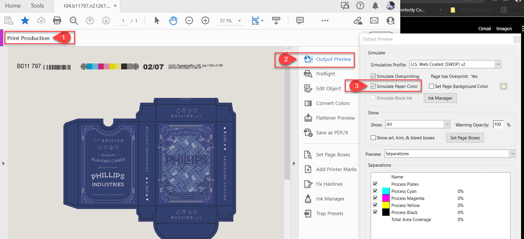

When you open the Canva generated PDF, and - in Adobe Acrobat Pro - if you (1) open the Print Production tool - then (2) click on Output Preview - is (3) Simulate Paper Color checked ON ?
