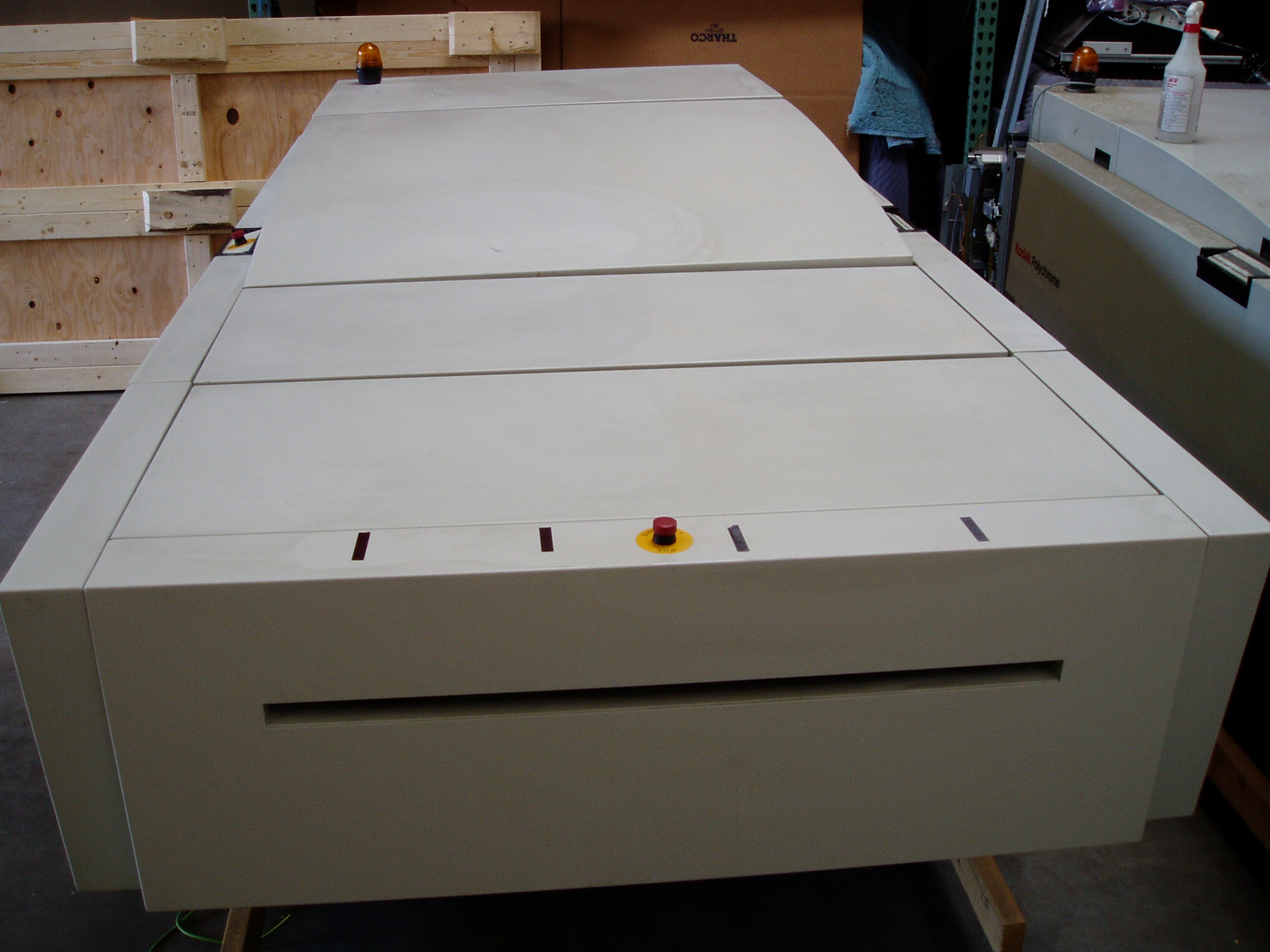

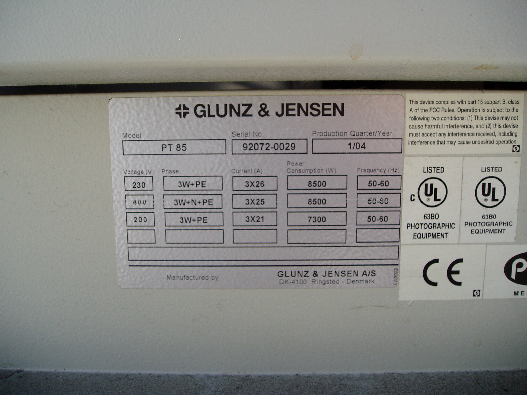

They all are Kodak PT-85 (Glunz & Jensen Interplater 85). In Excellent conditions.
Let me know if you are interested.
