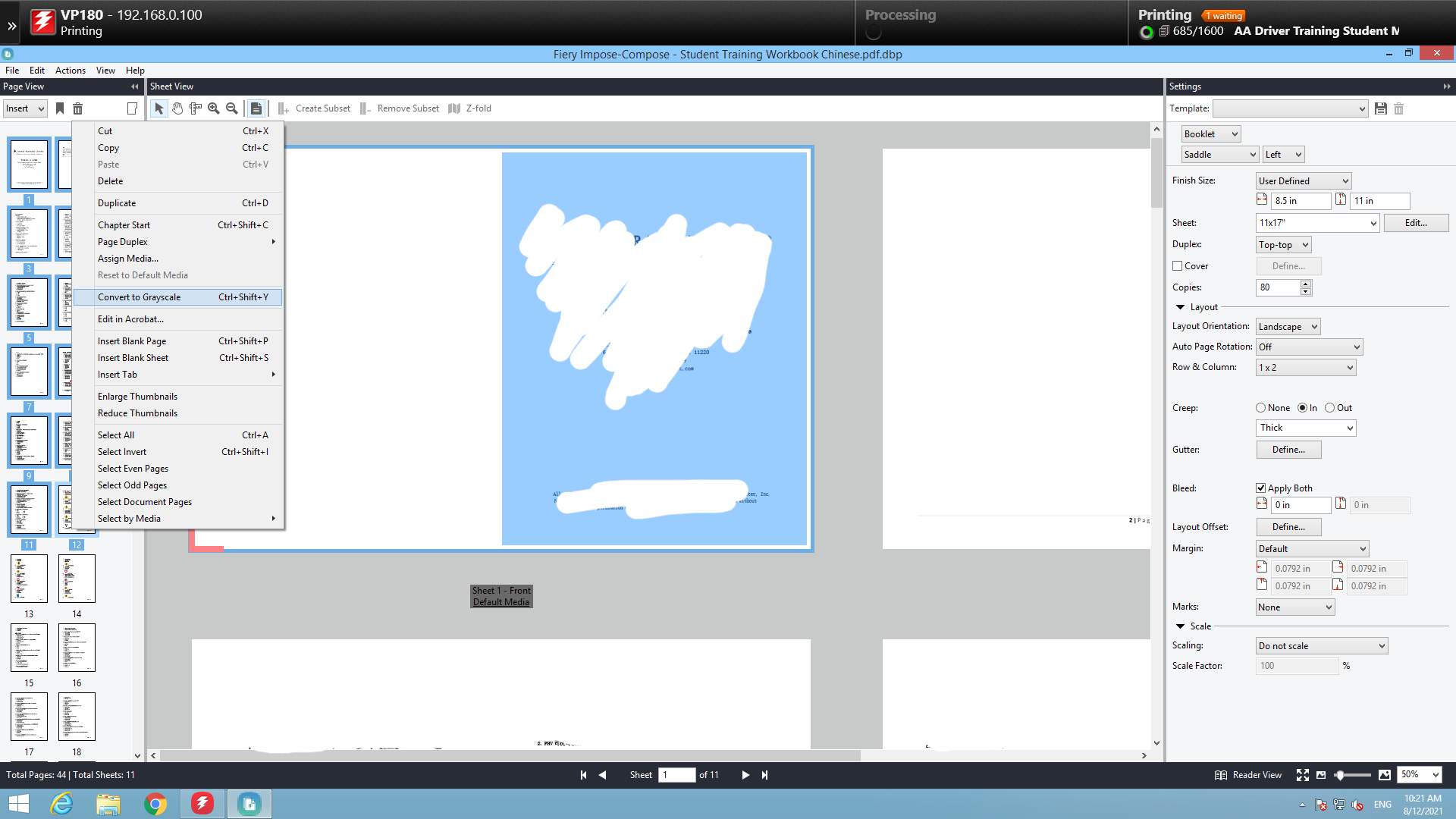

Heres a screenshot of the settings in Fiery Impose. If you run a lot of files with mixed color/black and white pages then I do think it is worth getting. You don't have to do as much file prepping and can just drop into Command Workstation and select whichever pages you want as grayscale.
Our application is most often books with several hundred pages, with mixed color and B/W. We print with crop marks that are registration color (CMYK). My prep guy uses pitstop global change to make the marks 100% K, no CMY. The pages of black type only are already usually set to 100% K, 0% CMY. This by itself gets the printer to recognize black only and color pages correctly.
Great tip never noticed that before! We control files we set and prep too, as Stickman42, but for customer supplied files in a rush, I love knowing that is there.
